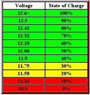

What are your batteries voltages once you stop and are at rest?
At rest, engine off, 12.5V. I'm picking up that the alternator will only charge to 80%, which I assume is around 12.5V, so does this mean it's my ignorance to worry, and actually all is as it should be?
Just after switch off it should be a little higher but should settle down to aruond 12.5v. So it sounds about right, it should be around 12.5 if its bluemotion. If the voltage drops off from there though within say an hour without any use of power it may be an issue.
