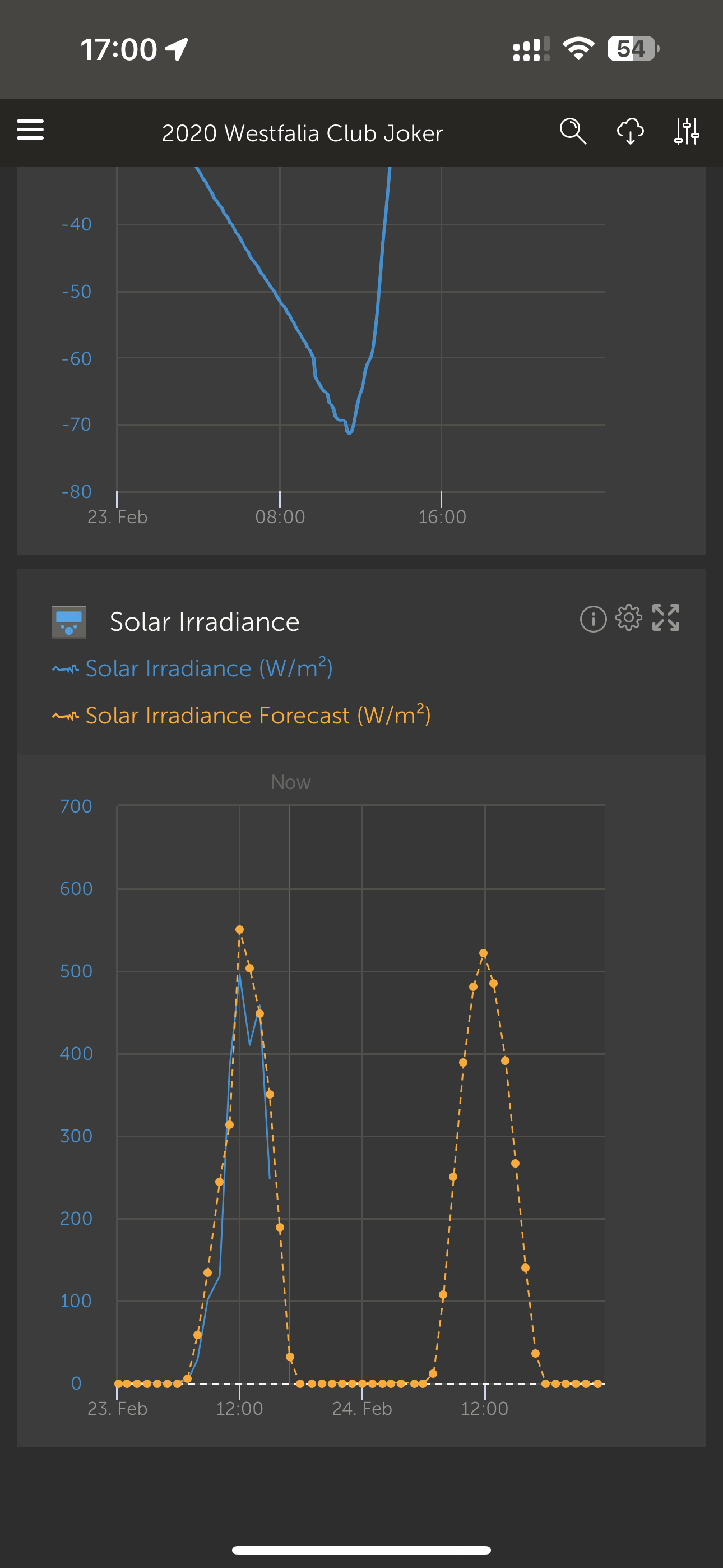

The point is that everyone needs to calculate their usage first. Your definition is different than mine of what off grid means. And that’s ok! For me it means I can do anything I want as if I were hooked up on EHU. Nespresso, Air Fryer, charging e-bikes, laptops, iPads and phones, having dashcams and a permanent hotspot.
Solar irradiation drops significantly in the winter months. Panels are rated with summer irradiation of an average of 1000. In Winter this can drop to less than 200-400 for less hours in a given day versus spring and summer.
So to solve for Winter you need 3-4X the power you would in Summer with Solar. And that’s assuming it’s a sunny day.
Solve for Winter and any other season is a breeze.
Here’s a live chart from my van showing the solar irradiance for today and the forecast for tomorrow. This takes into account weather as well. As you can see it hits about 500, but only for a short window of time with about 2-3 hours of charging at decent rates.
