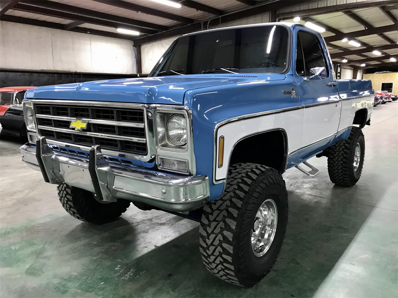

Mine is blue and white. Luckily it's dark blue, otherwise with swamper wheels it might just look like a smurf with hiking boots.
Don’t tell that to this guy:
