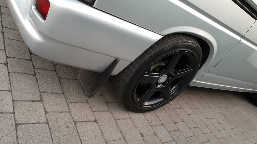

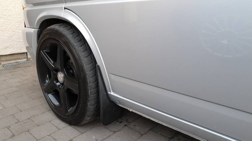

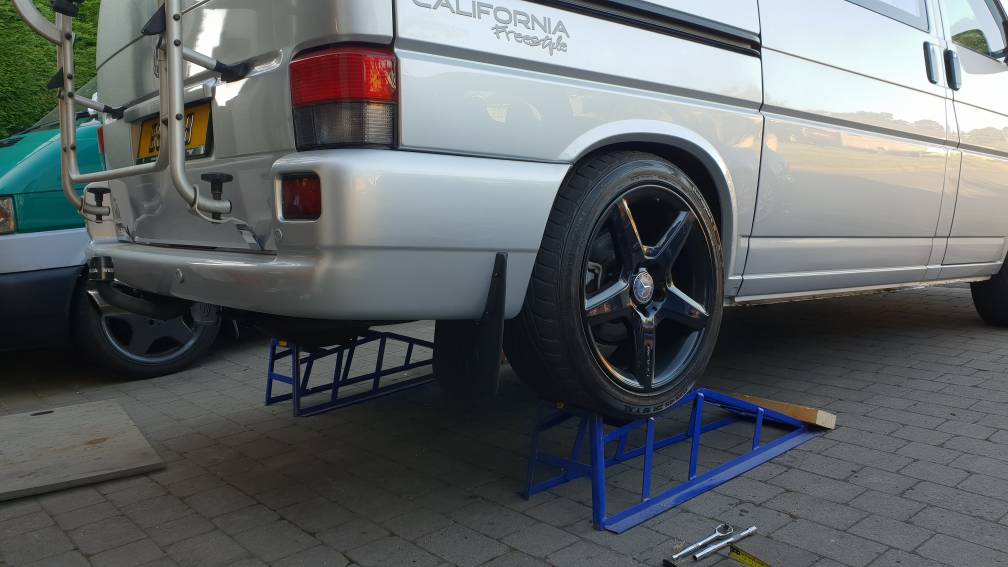

Tonight I decided to fit mud flaps to the Westy, I'm not normal a major mud flap fan but when running wider than standard wheels I like to try and stop stonechips up the side of the van. Now they're on I don't mind them tbh.

I've bought the fronts (though not gotten around to fitting yet). I didn't get the rears though - didn't like the idea of drilling the rear bumper... You're happy with the result?
Yeah I wasn't sure at first myself but just went for it, if needed you could smooth them the holes or replace the bumper in the future if you wanted them off.
Everywhere said I needed a different rear kit (which is now obsolete) as the van has aircon but you don't, the normal set fits, you just have to move the rear ones 20mm further forward than normal to clear the gas box floor vent ducting. You dont notice that anyway. Overall, well pleased with them.
