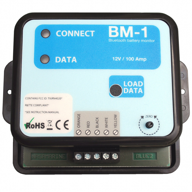

The monitor is a small lightweight box and a 100amp shunt it has no screen so is reliant on your phone or tablet to get a read.
Wiring it up was very simple as the shunt comes with a wiring harness the most difficult part was accessing the battery in the beach. I did have to strip the wires in the wiring so they could be attached to the monitor and locked in place with screws. You will need wire strippers. You then put some load on the battery for a few minutes as it figures out your setup. I popped all the lights on.

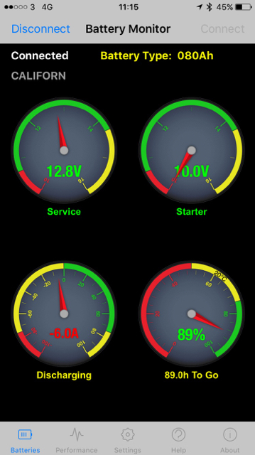

First impression is wow it's ugly! Like something from the internet of the 90s.

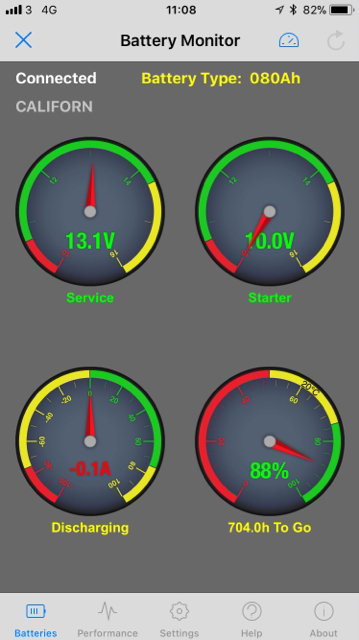

You click connect and it almost immediately showed me the monitor and I selected it. You can update your battery name and amp rating and the click update. You then have 15 seconds to get the load data button on the device to update the monitor.
That said all of the information is there.

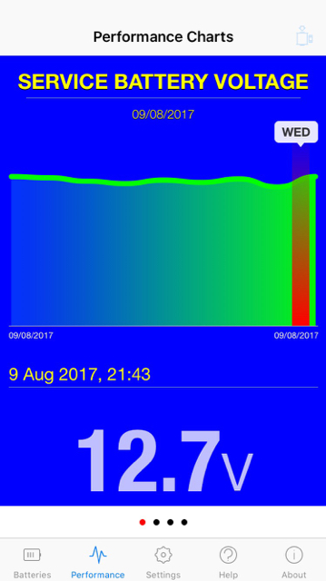

You can see charge or discharge status the condition of the battery (this has improved over the past day) and voltage. So when my solar is connected or i am on hookup I can visibly see how much is going in (or out). Handy to decide if I need hookup (or a bigger panel) ;-)

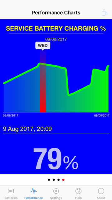

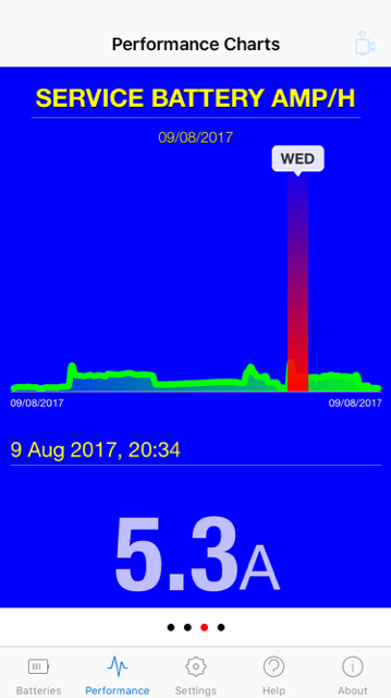

There are also some graphs available over time. Handy to see but the interface isn't very good. You literally have to hold your finger on the graph for the info to show which is awkward. You can't slide along either that scrolls to the next graph.

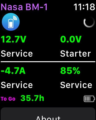

Does also work with Apple Watch I should have mentioned

The time remaining counter is useful for constant loads, of course the fridge and heater aren't constant. However it does give a good indication of power use and reflects in the overall charge percentage. Useful. The calculation for time remaining seems to fluctuate quite a lot which doesn't give me confidence in it. E.g. 89hours at 6amps clearly isn't right or the 35h at 4.7a. I may have just caught as it was updating however it eventually settled at 16hours.
Here the fridge has been turned on from warm and the max draw of amps is 6. However once cold it uses less and is barely on.

This will allow you to use the apple watch to check the details without looking at your phone. This isn't a live feed but updates every 3 seconds or so.

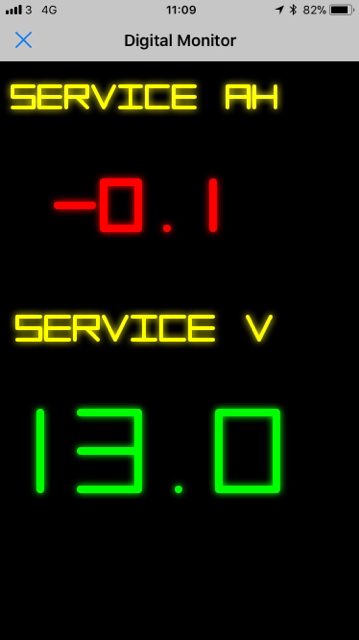

Apps been updated but can’t see much difference to be honest. Now has a monitor mode and slightly nicer looking:
I should say its now connected to my starter battery too, so I get read outs for both batteries. You only get volts for the engine battery but that is enough.
