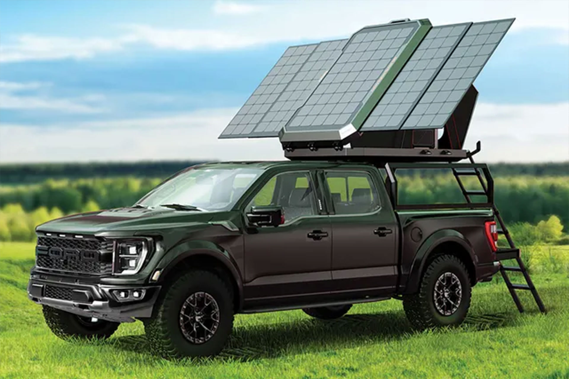

Solar? Put this on your Jimmy.
Would tip over. Jimny wobbles like mad with very little on roof and payload is only 30kg including bars!
Some YouTuber have done it and said the Jimny handles ok, but the main guy Geordie Jimny camper has been trying to shave weight off the roof for years and even built his own roof tent and has updated suspension.
May get one for the Ford as extra sleeping if I go that route.
