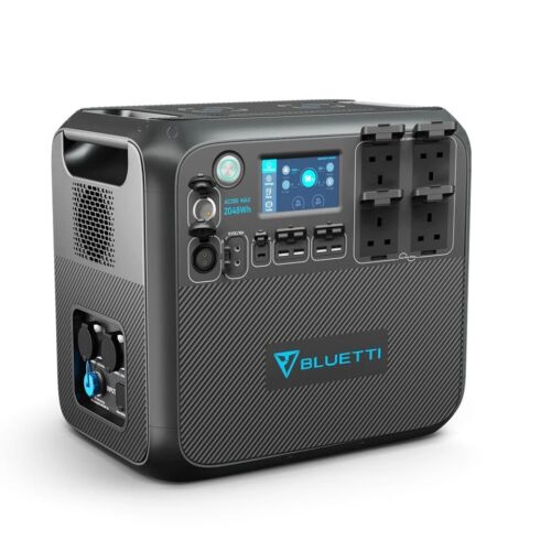

I use a solar generator (Bluetti 200AC MAX)
...for 2kWh of upto 2200w continuous output. It has it's own BMS so I plug the 200w solar panel directly into it when stationary and charge from the vehicle via the 12V input when driving. It cost less than what you are proposing with 2 x 100ah batteries and uses the same LiFePO4 lithium IRON (not ion) technology - good for 3000+ cycles.
All the convenience for micro, air fryer, TV, etc and none of the hassle, though a Jackery 1000 is half the cost and almost as good if you keep everything below 1000w output. Highly recommend this route rather than changing the DC/DC charger and batteries and cables / fuses, etc.
