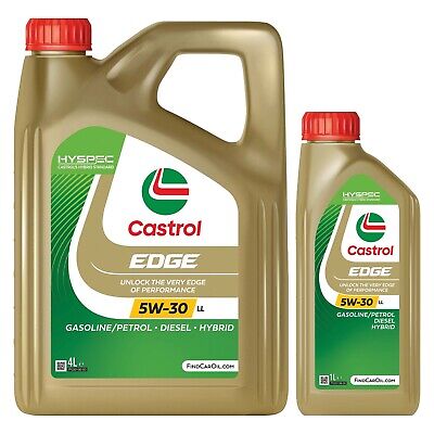

Sorry for such a basic question but I have looked in my manual to no avail - is there a particular oil I should buy to top up ?
I've always used this in my T6. Note you need the Long Life oil (LL)
Note only fill to half way up dipstick when hot & on level ground.
