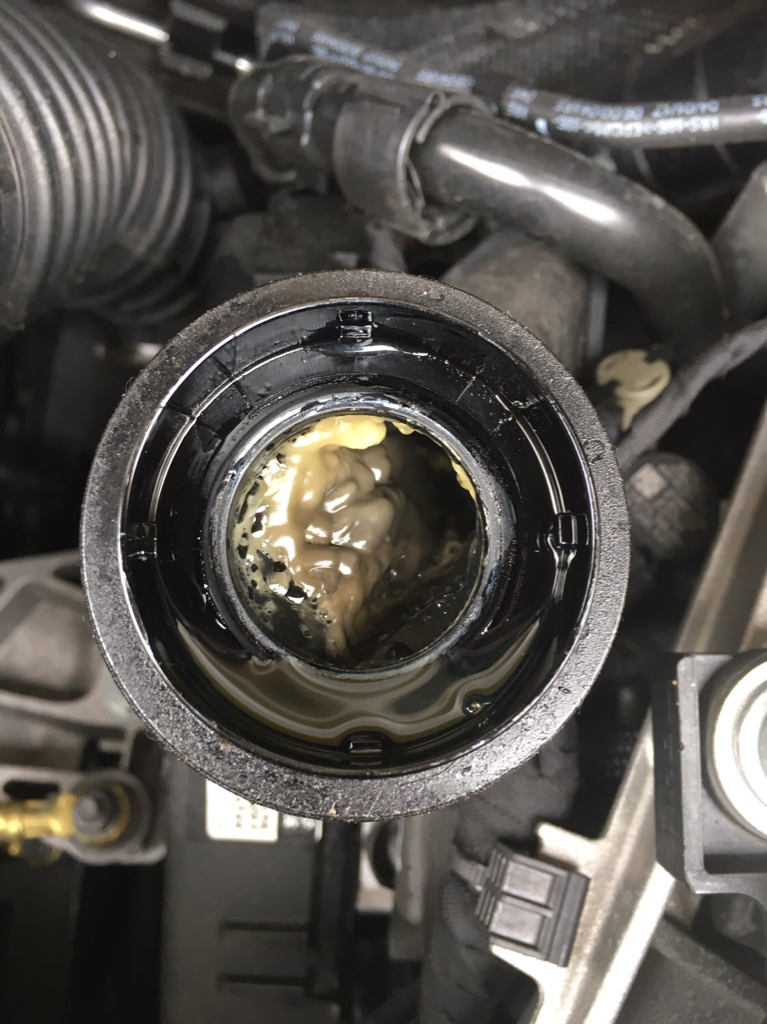

I have been monitoring the oil level in my MY17 T6 Ocean and after 6000 miles it's slightly below the middle of the range of the dipstick. As a small oil bottle is supplied with the van, decided to put a little bit in.
I took off the oil filler cap and saw this. Looks like oil water emulsion, which is not good news? Oil in the dipstick looks completely normal

Certainly would get that checked, I have never seen anything like that in my 2015 but have on older vehicles and it was head gasket issues. Is there anything in the water too, in the water is when you really need to worry?
Either way its getting in there and shouldnt be.
Don't worry about it. Just a bit of condensation.
Use the van. Take it for a good run and it'll disappear.
Thanks. Water looks fine.

There is a post on here somewhere about the new T6 engines and condensation, SideP has already mentioned it I believe it is also in the manual ;-)

Normal on the T6. Has a long Oil Filler which doesn't get warm enough. There is a VW Technical Bulletin about it.
You could try some Foam Pipe Lagging around the Pipe if you want to get rid of it, but perfectly Normal.
See Technical Guide in VIP Download section
