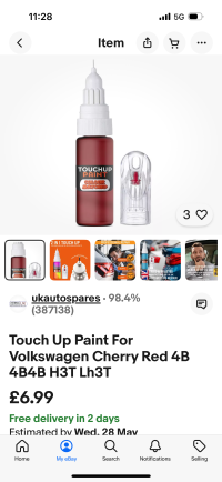

Can’t find a code for the paint on my red t6.1 Ocean . 2022. Have checked all the usual places

Alternatively tinternet search / Ebay etc will throw up colour codes

By the way I found this on an alternative T6 forum from 2017- I think it must have taken considerable effort and might be useful! Thanks to Pauly.
SOLID: Candy White - LB9A, 9021, B4B4, B4
SOLID: Pure Grey - LH7J, J2J2
SOLID: Cherry Red - LH3T/ ?LA3E
