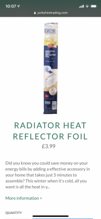

Easy DIY project but I wonder what people’s experience is when camping in HOT weather? Would this help to reduce leisure battery usage I wonder?

You could attach some radiator backing foil with removable velcro cost about £5 all in
I’m just questioning whether it’s worthwhile? I’m doubtful. But if it is, I might carry some silver radiator foil as suggested for off grid hot summer days.

We have had this radiator foil from the DIY market in use several times, when the Cali couldn't be parked with the fridge side in the shade. If you have to park sunny side up, it helps (a bit) to reduce heat piling up under the fridge compartment.
In the old T5.1 this is a common problem, shutting off the fridge as well as shutting off the charge controller. They both quit above approx. 54 degrees Celsius. In the T6 the charge has been replaced to the back, above the battery.
The foil should be folded double, and hanging a bit loose, so that air can ventilate under it. I have put a wooden stick in the lower end, to keep it down.
The advertized version which is sticked tight onto the metal, is worsening things. It's only collecting more heat.
