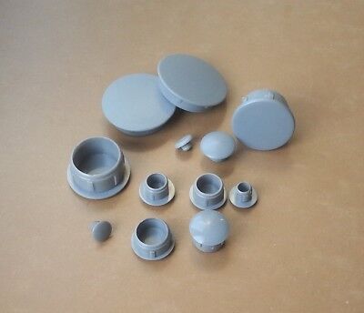

I didn’t have much trouble following @Brownbetty’s method. I used the 4.5mm punch from this set:
Blue Spot 22443 Parallel Pin Punch, Black, Set of 6 Pieces https://www.amazon.co.uk/dp/B0751HCHDB/?tag=eliteelect-21
And was able to achieve a factory-look finish using 4 grey plastic hole plugs from the bay. 15mm hole diameter have a firm fit that will stay in place when seat is in bed-mode:
