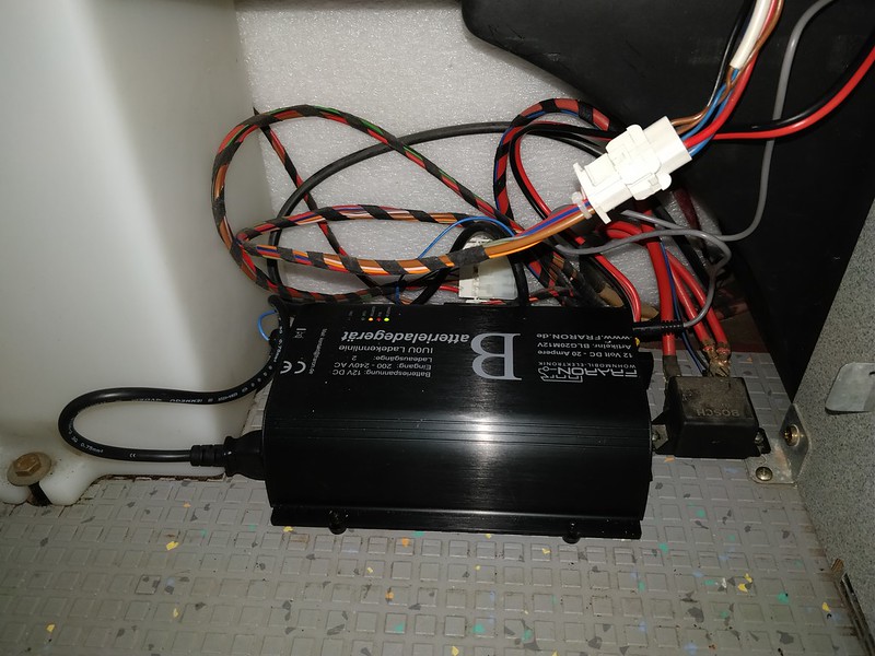

There are quite a few of us around if you know where to look. A number of topics have been covered before on the forum so it’s sometimes worth doing a quick search for any problems you may have. The charger is one of those such topics. It is possible to buy the original charger still at vwbusshop.de. Other folks are fitting a much cheaper and more modern equivalent that still supports the display features on the Central Control panel. You can find some details on that in this thread.
I recently had to change my charger after the original recently went pop...
Search the forum for 'Fraron', also here's the link to the one I bought:
https://www.fraron.de/en/a-85859176/
Had ours since July, my thoughts so far... seems to do what the old one did, main 'obvious' difference is the fact there's a cooling fan on the Fraron (which the old unit didn't have). Its not running all the time, but certainly during heavy charging periods. It's slightly noticeable (the fan's noise), but not so obtrusive as to bother - well we don't find it so... (Liken the sound to the fridge compressor, maybe a little louder...).
As mentioned above, the nice feature of this charger is that it still makes a connection to the display in the cab so you can see when your're on the hook-up. I don't know for sure, but I also guess that this is a more 'intelligent' charger (as it has different charging profiles depending the battery state - although I don't know if the old unit did the same, maybe someone could comment on that?), so the logical assumption from that would be that the battery should benefit and maybe prolong its use...?
Good luck!
I also had to replace my original charger recently for the same reasons.
After looking about and pricing up a replacement original charger, I went for the Fraron unit - still expensive but it was straight forward to fit. Its a higher output than the original and a more modern design so it should look after the battery better in the long term.

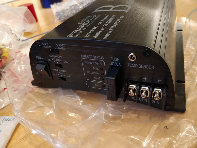

The only extra things I had to purchase was an angled adaptor for the temperature monitor as the supplied 3.5mm plug wouldn't have cleared the original furniture panel and also a 30A in line fuse to connect to the battery. (I tried a 20A fuse originally as this is what the charger is rated at - but it kept popping. I then read the German instructions that suggest a 30A unit)

I've replaced my charger for the Fraron unit. I'd seen too many posts of the original going up in smoke. I've seen quite a few posts on facebook in the last few months of the same. There was a post from someone who found a re-engineered charger but the fraron unit looks very professional. Its got dual output too so I've hooked it up to both batteries.
Don’t forgot the original replacement from Günzl is a dual output so will also charge your engine battery.
Does the Fraron unit do this?
Yeah I posted that. I've hooked up mine to both now and works a treat. How much was the Gunzl one?

It comes with connector cables but I needed to modify mine slightly to fit onto the battery and the split charge relay for the second output to the starter battery. It comes with the connector for the temperature sensor and the correct plug so it still works with the Westfalia screen at the front.
