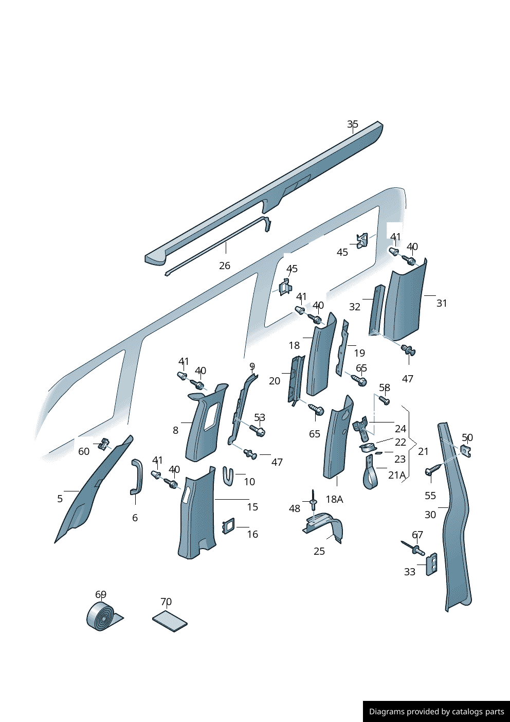

That parts list shows the upper trim as a separate part so probably held on by push fit trim clips ..
Have you tried easing out the centre light to see what’s behind. That is a push fit.
I see. I thought once the window was removed you might have been able to tease it down far enough.
I going to have to have a Tease of it with the trim tools. I reckon if I can release the long bit betwixt the wardrobe and b pillar it will hang low enough to get my hands In There.the blind definitely goes above the window
I going to have. Tease of it with the trim tools. I reckon if I can release the long bit betwixt the wardrobe and b pillar it will hang low enough to get my hands In There.
You’ll have to remove the C trim and possibly the upper B trim panel.
How's the c trim held? Assuming push clips
Parts 18,40,41 and 45.

I need to get part 35 off without taking the kitchen out. The runners for the blind are riveted in
