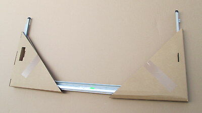

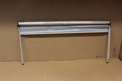

Side looks to be different as comes with frame. See below which has photos of replacement unit, looks to have 3 fixing holes on each leg.
i think with the c pillar and b pillar trim off i can see the rivets that hold the legs in. if i can then prize the roller casing out by having the long roof trim sort of hanging loose from the wardrobe end then i'm in luck. yes that ebay one looks like the one,going to try get it out first and see if i can see a part number

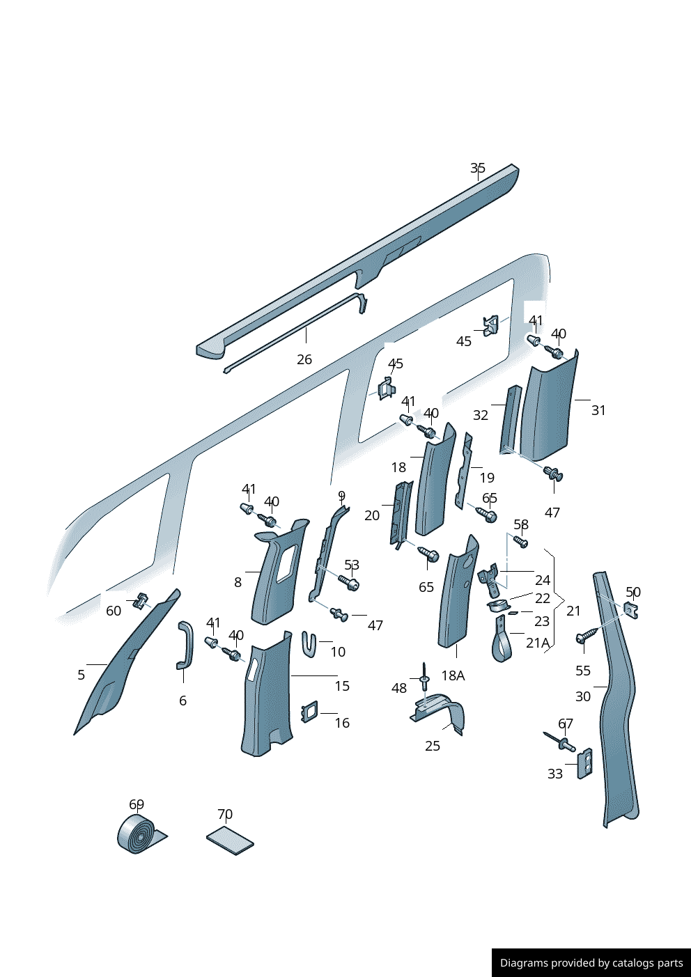

Parts 18,40,41 and 45.
versa.
Can I ask where you found this diagram from please, I need the piece of trim Item 10 for the blind on the B post.
Click on the “ Google “ link below and select year of vehicle. You’ll find trim parts and Part Numbers under Body.

i do. i doub't you will be able to get the blind working again. i gave up with it and got a new one.heres the remains of my old one. Your welcome to any parts. I got a new one on ebay for 100 quid un the end. Those plastics are very fragile.try taping it up,one the blind is riveted in place it won't be noticeable?
