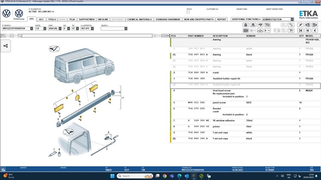

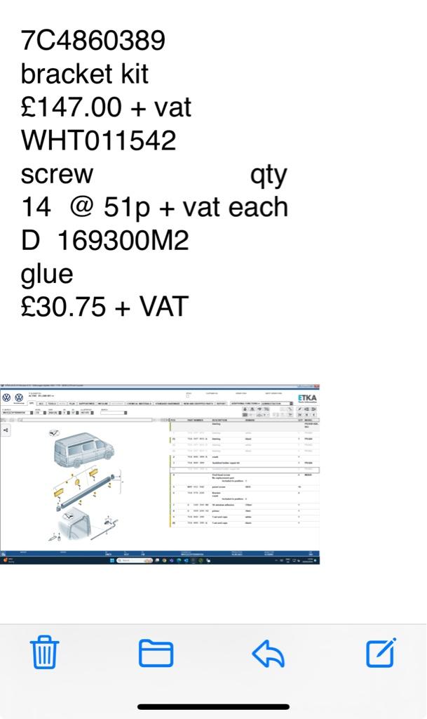

No they bond it on the out side mine is being donee by Vw at a cost£1200 fully fitted GC 680
I got mine from breeze Vw commercial Southampton 4 weeks ago they have checked it out and that’s how they fit them just waiting for the Thule awning to turn up may be July if not t think September cos of holidays in Europe I keep you posted
