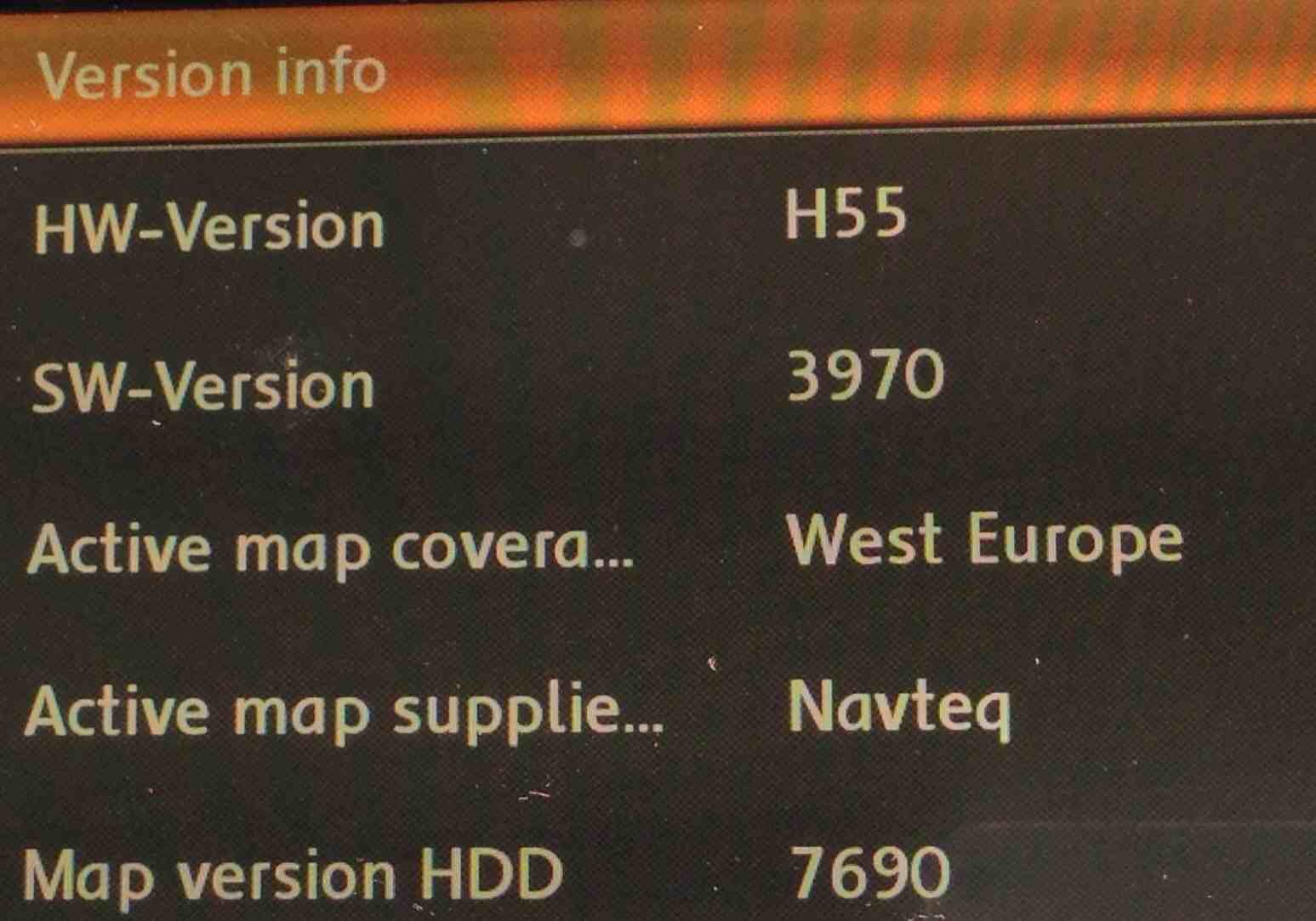

Spurred on by a recent post, I was wondering whether the procedure to flash the firmware is always required in order to simply update the maps, or if I can find out somewhere.
I've SW-version 3970 & maps 7690 (Navteq) see pic
Is anyone aware of this kind of info reliably available anywhere?

Recommend the VWnavi forum for RNS info. 3970 is reasonably up to date firmware, no real issues from my experience. I believe there is newer, but with little benefit in terms of features (radio text maybe?)
Map updates can be done independently, I recommend only flashing firmware if you have issues, it's quite a scary experience :)

Andy, did you need to use VAGCom to enable the hidden setup menu that displays the version information? Been trying to discover the version of mine - to no avail...
Thanks Maq I've seen some horror stories which worried me a bit (& I work in IT infrastructure)
Danny, it's quite straightforward. Just keep holding down the setup button. Keep it pressed when the normal setup screen appears & also when radio service mode appears & you then get the testmode menu. Choose version info at the top :)
