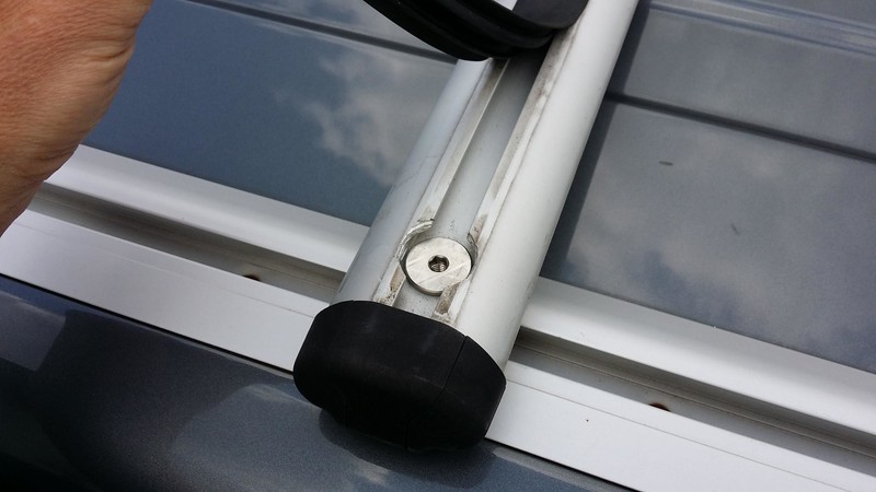

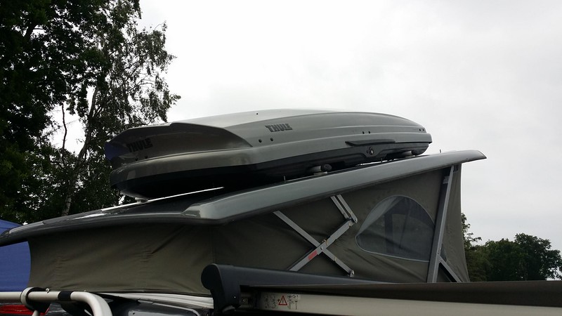

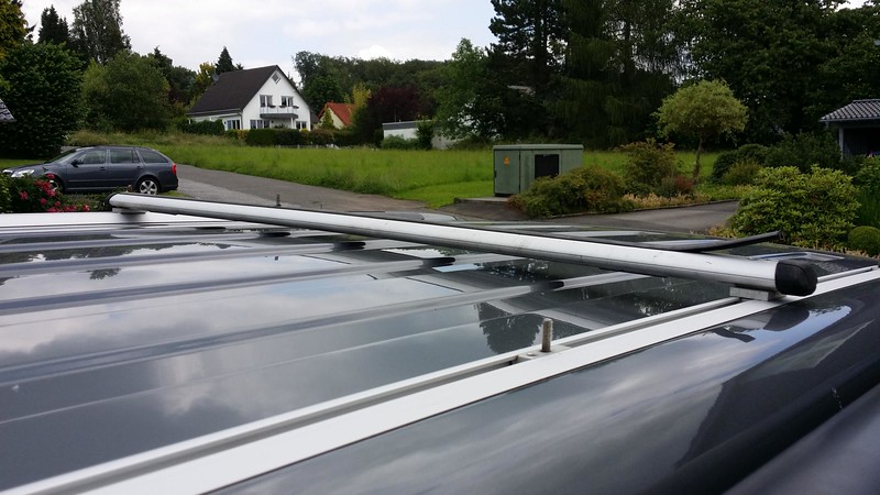

I have found an interesting way of mounting a roof box to a California as flush as possible.
Thule bars mounted almost directly on the roof C-bars
More info here: http://www.caliboard.de/showthread.php?11647-Welche-Dachbox-habt-ihr/page4

Do you need customize any parts or just remove the rack legs?

I like the way you have done this. I have some spare bars but it the "correct" feet and was about to buy some. However your solution is very neat.
Can you tell me which fixings you bought and where from? It looks like a Allen bolt and nut set up but if you found something you can advise it would be good to know.

Where did you get these parts from please?
Not my solution but I will most certainly do the same with mine
The roofbox is a Thule Dyamic 900, it is now called Dynamic L.

I used a roof box for our Scottish trip on a 3 seat Beach, not sure if you have a beach or a Ocean etc but for a beach we ditched it shortly after the trip.
Good thread here discussing the pros and cons.

It's a t5 much like the ones in the images discussing flush mount. I really like the low profile of this solution.
