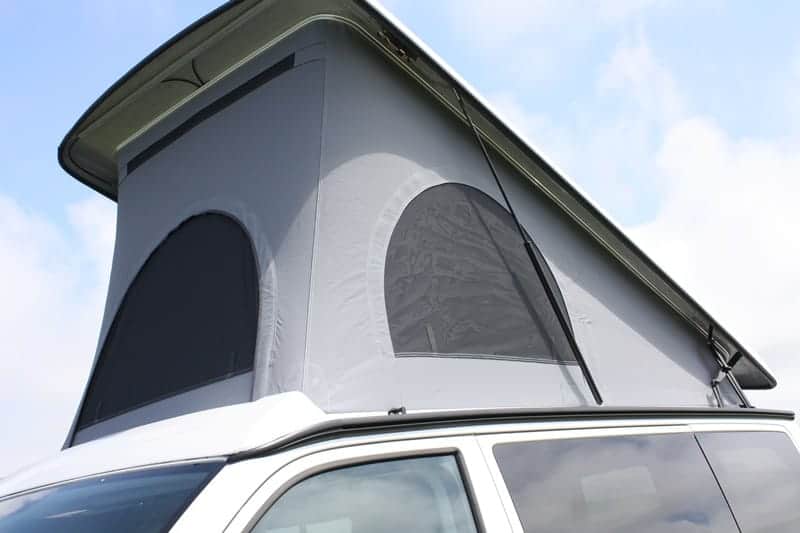

AUSTOPS​
Our top seller! Manufactured in the UK, Austops are our most popular poptop roof. There are 20 canvas colour options and the fantastic Panoramic option so you can open up the roof to the outside world

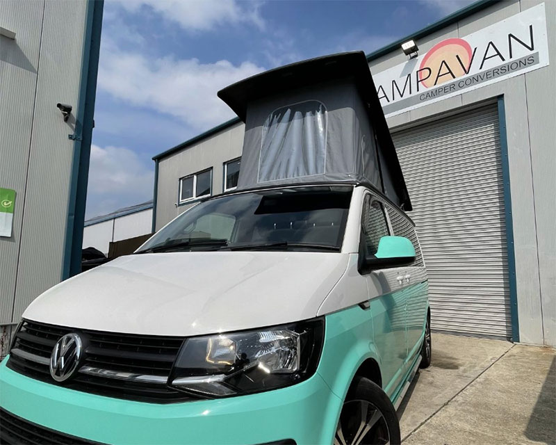

May be worth trying Kernow as they have fitted the new canvas for some users ...
I had a price off these guys a while back.
Think it was about £800.
I’m sure that price will be more today as things have become more expensive.
I’m guessing these chaps are probably the place to go, as they’ve been fitting California roofs to transporter vans for some time, therefore must know the product very well by now…?
