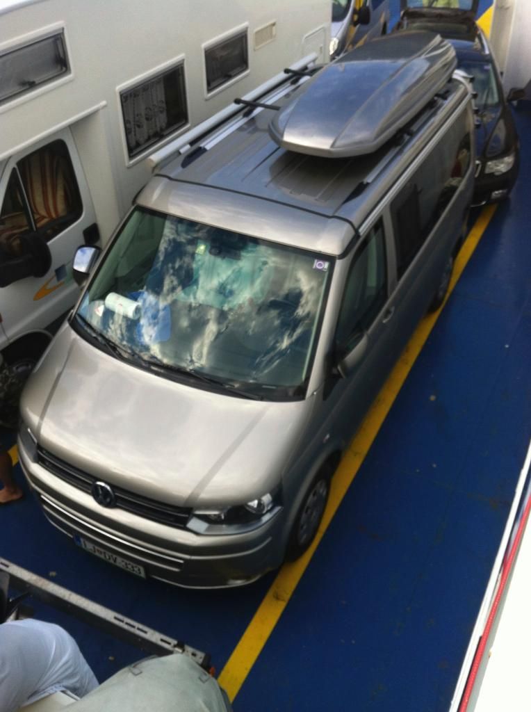

This is a photo of ours with Thule box.
We are not using it much as the Cali does not fit in a garage due to height and we tend to have less stuff on our trips. We use another car for winter and skiing and the box goes on it when needed.
Out of curiosity, is there a reason for not placing the box on the off-side; would it not be more easy to access the box by standing on the rear door step then?

If, you mean the right side of the van, there are difficulties to access the box because of the awning. If you are parked in a camp, you need to close the awning to get to the box. We used the box only the first season, then I persuaded my wife we don't need that many things with us. :thumb
We are traveling with less and every year. But, we are almost every day on a different location. I would take my kayak and bicycles, if we would go camping for a week.
