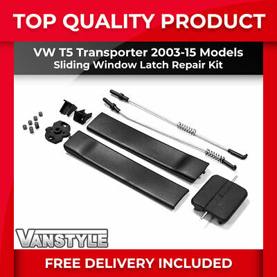

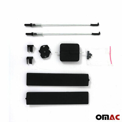

As @westfalia said, replacement catch/ lock available. £7.99
Video of replacement.
It may simply be a case that the top rod is not engaged in the cam, (operated when pinching the catch, possibly a simple fix,
if something is broken get a new kit and replace the lot, as all the gubbins are plastic except from the lever rods. The plastic parts will not last if glued
very easy fix if you have a modicum of DIY ability.

£7.99 fixing kit has arrived.
I've dismantled the pinch switch of the sliding window and gorilla glue doesn't look a solution as a poster above suggested.
The rotating articulation of the pusher with the cam had sheered at the rotating joint.
so i just replaced everything.
seriously fiddly.
i'd read somewhere it was a 15 min job.
with the window removed it took me 2 hours.
the video was very helpful.
putting the sliding window back in place once the pinch switch had been fixed was a nightmare.
another hour.
so thanks for the help y'all.
