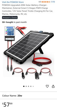

I do not use ours very often and its away from house, so I wanted to fit a solar panel in windscreen, can anyone recommend any please, most seam to be useless
Are you thinking of installing a solar panel on the roof in the future? If so it can be wited to charge the leisure batteries AND the starter battery.
No do not want a permanent one , I have a large suitcase type panel , but to large for windshield
Put the fold open suitcase type solar panel on dash board and its now charging my leisure battery up from 11.00 volts to 13.6 volts so now happy with that at the moment
The smaller one is plugged into cigar lighter in ashtray ( to engine battery ) the larger twin panel plugged In cigar socket on side if kitchen ( to leisure battery ) my tracker tells me what voltage is on the leisure battery
