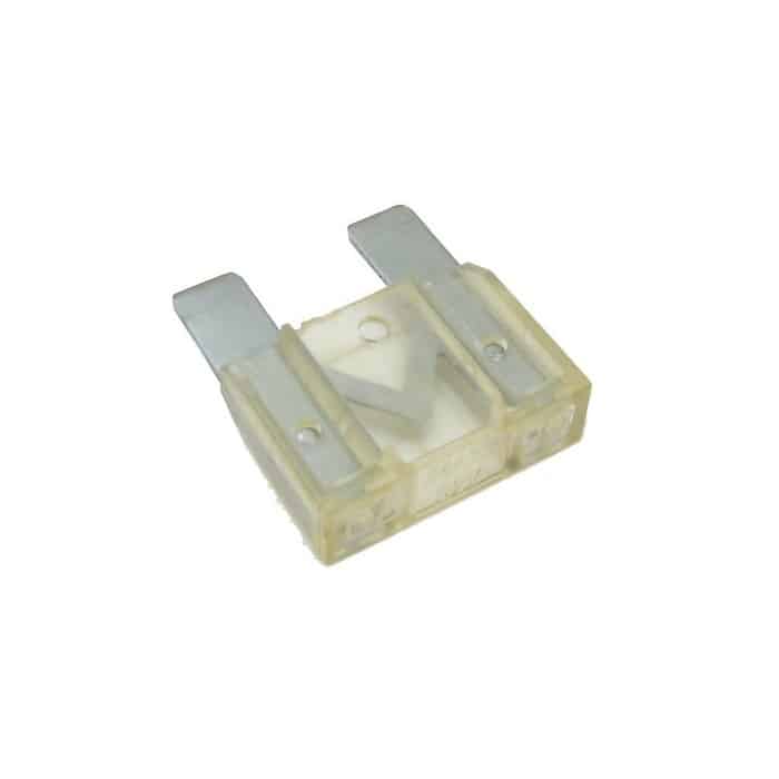

Can I ask where is the location of this fuse or fuses is it on the rear battery positive + supply or are both battery leads fused , I am considering installing 2 off 100w panels this should run your fridge for ever
Rear Leisure Battery on the Red Positive. It is there to protect the long run of that lead to the front Leisure Battery. Solar panels are normally connected to the Rear battery.
It's on the positive terminal of the rear battery.
Thanks for the location now I see why there is a 50 amp fuse for sale in the shop ill buy a couple for the tool kit ,
Could you post a link for the 50amp, Battery Post fuse, you have found in the Shop?
I can see the 80 amp blade fuse which is part of the Engine charging circuit for the Leisure batteries .

Great news. Replaced the 50a fuse and the solar panel is working well.
I used the fuse from a company 12voltplanet.co.uk recommended to me by WelshGas. They were ÂŁ4 rather than the VW ÂŁ10.

As the OP's vehicle is 2007 vintage then the present Leisure Batteries must have been replaced prior to the present owner purchasing the vehicle.
I wouldn't be a bit surprised if they replaced the rear battery first and then went on to replacing the front battery. Removed the Red Power Leads, not realising one of the two leads was connected to the Rear Leisure Battery. Pushed the leads aside and pop went the rear fuse.
Question - is there a similar fuse on the front battery?
@WelshGas Is there a fuse on the front battery as well as the rear?
No, but their is a Large 80 amp Blade Fuse between the Split Charge Circuit and the Front Battery in a in-line Fuse holder , under the Front Passenger Seat. It is rarely problematic but difficult to come by. I think the Forum Shop sells them and I carry a spare, just in case.
Without it there will be no charging from the Alternator.
