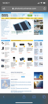

For those looking at uk based portable solar solutions this company also has a good range of options

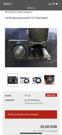

Saw this on the Calitop site. Might be a good connection solution for those wanting to go with portable solar?
