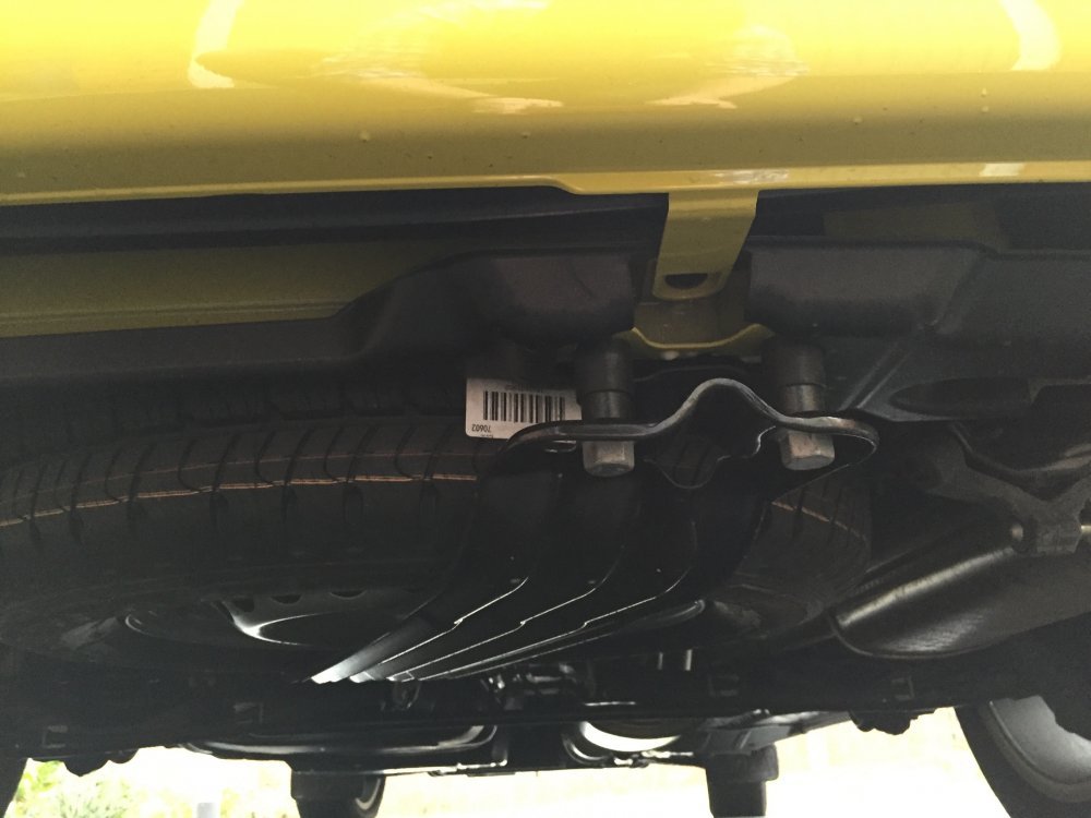

A couple of members have recently posted that they were having difficulties fitting the SpareSafe.
I thought it might help if there was a picture that people could refer to.
The first is from the rear of the vehicle taken last night, the second is looking from the side so you can see where it fits. Hope this helps.

Thanks Simon, this would be for the mechanically inept like myself ;-)
Like I mentioned on PM, with no safe in place I can thread in the Safe bolt and the VW security bolt with only minor adjustments, with the safe in place, both bolts keep cross threading, or jamming against something. I'll have another crack tomorrow. The other part of my ineptness was the positioning of the safe. I thought the barrel of the safe replaced the barrel of the bolt, rather than sitting below the spare wheel bracket. Anyway, lesson learnt, he who dares n'all that.
It's on, although I question the quality of the machining of the security bolt. I didn't want to use the VW bolt, just in case anything happened to the socket points and if they got caked in muck, it might be tricky getting the socket to connect. I loosened the main bolt also so I was able to get the plastic cylinder out, clean it and make sure there was no crud in the threads above. The Sparesafe bolt went in, but took a good dose of WD40 and working the bolt back and forth a little at the start.

Well done. It's a very exposed location so I suppose all the crud & muck off the road gets thrown up there and gets caked on. Well worth doing though. I live in the middle of Bristol and two of my neighbours have had their spare wheels taken from their T5s, mine wasn't. I'm hoping that was because of the SpareSafe being on there.
