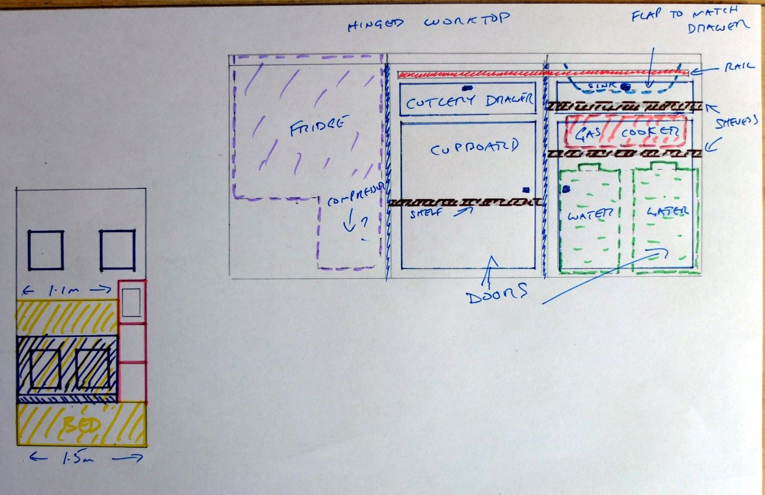

I just did a quick rough and ready sketch - will take some juggling but I'm sure it could all be fitted in.
So fridge maybe with separate compressor to left with same type of opening worktop as Cali SE. Smev sink sunken with glass lid as usual on right.
Under sink is flap to match drawer in middle with shelf to store pans under sink.
Second shelf under this to store cartridge gas stove which simply sits on top of worktop.
Water storage under stove storage.
Doors match to middle and RH side.
Cutlery drawer to middle top and shelves below in cupboard.
Trimmed in blue with vertical dividers/construction as per the T4 Cali unit I pictured further up this page to match Beach decor.
