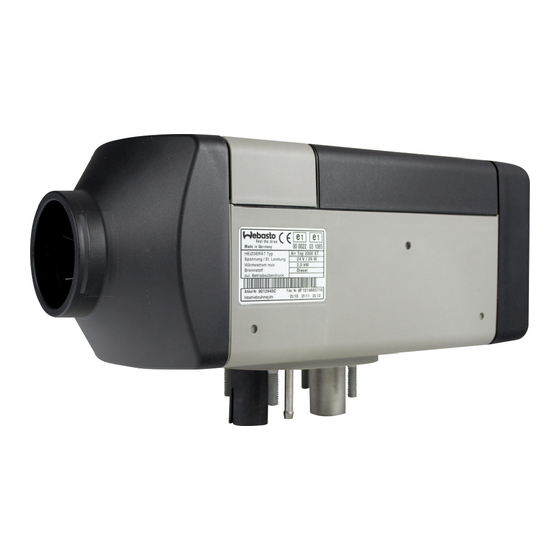

Hi there - we've a 2006 T5 ocean, and tried to run the auxiliary cabin heater for the first time in 18mo+ last weekend, and it just doesn't start. There are a couple of good threads on the forums already, so I've run down some fault finding already:
  • control panel shows it as working, with the light on and not flashing
  • plenty of diesel
  • batteries seem fine, and the same happens with engine running or on/off hookup
  • no error codes from the hidden menu in the control panel
  • no error codes on OBDII through Torque Lite Pro app
  • I've checked all the fuses in the cabin and under the passenger seat (continuity with multimeter)
I thought I saw somewhere that there was a procedure for resetting a trip-out by pulling fuses, but I can't find that thread (insomniac scrolling is not the best way to fix these things!). Can anyone confirm if there is a reset procedure and point me to it please?
We haven't had a lot of use from the heater the last few years as we've been fair-weather campers with 2 young kids, but this year is looking like some soggy mountain-bike trips might be on the cards so I'd like to get it working... Any other suggestions please?
I'm really hoping this isn't going to be an expensive VW visit - we're in WF17 if anyone knows of a good place to take it to.
Thanks!

Eberspacher recommend running the heater for an hour monthly.
VW is not the best place to go. They will just suggest supplying a new one.
Eberspacher Service agents would be the best place.
Earth shunt?
Does the fuel pump run (ticking noise)? Can you hear the fan running if you put your ear to the duct?
If the above are ok then it’s almost deffo the glow plug. Simple 5 min change.

Thanks. From the door pillar stickers it looks like we have the Westbo Air top rather than the Eberspacher. Good news is that there's a service centre for that close by: https://www.melloronline.co.uk/
Earth shunt?
Might be, but we don't have other symptoms (flashiness) and it doesn't work not hook up either. The fridge box is damaged at the gas strut though so it might be a combined job over winter...
Nope, we used to get those but nothing at all now, so it seems electrical (your earth shunt comment is good) or a trip-out...
It looks like there's a lot of stuff out there on the westabo, but I've not found a rest process for it yet. Or removal instructions...
I sense a bit of time lying on a cold driveway and shreading knuckles in my future
If your good with the spanners take it off the van and then take it for a service or buy the kit and do it yourself. The kit will more than likely include all the gaskets,o rings, burner matting and glow plug. The burner matting is directional.
Any use?
This thread contains a couple of Vids that will give you a good understanding of how the heater works and how easy it is to disassemble &service etc.
If none of pump/fan etc are working it suggests to me it’s not the heater unit, more likely the interface with the van ie, control box/power supply/earth.
……that said, the software may look at the glow plug resistance before it allows start up. If it see open circuit (dead glow plug) then it may just not allow any start sequence.
I’d try a new plug first.
My engine coolant heater was dead and I had no pump/fan initiation at all. Fitting a new plug and away it went.

That's the one... the question now is which darn fuse is it? I'm guessing the most difficult to reach 25A under the seat, but very happy to be given another suggestion as any other fuse would be easier to reach :D

No luck with the reset on this fuse...
As it’s not been used for a while it might need a full service if there is a fault before the Reset works.

Once the undertray is off best way to get the heater out is to disconnect the fuel line, cut xip ties securing the big air hoses that go into the step and door pillar and then remove the heater and its mounting cradle as one unit then disassemble to service on bench. I tried removing the heater but leaving the cradle on the van it dont work not enough wiggle room. Cant recommend the benefit of investing in vcds enough to enable diy repairs.

So I'll take a look at this, but for now the friendly local garage plugged theirs in and reset an over-temperature error, after which it ran happily for an hour! I'll give it another go in a couple of days, but I'm hopeful that this'll be it.
If it does go bad again, I had some really useful conversations with melloronline who are just down the road from me, who would be able to service the heater (or supply parts) once it's off the van.
