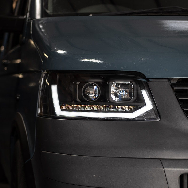

They won't fit. Get the T5.1 LED ones from Transporter HQ. Speak to Bognor Motors, they supplied and fitted ours. (think they were £650 incl fitting)
