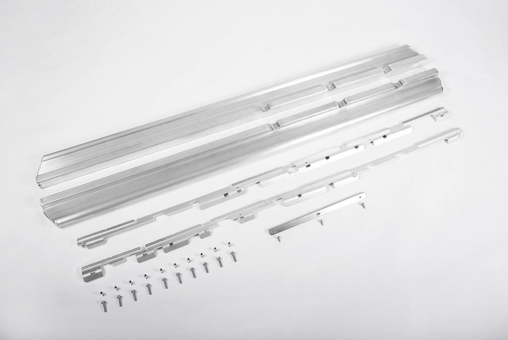

Just finished a year and 33,000km just in South America. #1 item I would add is the Seikel rock sliders - they are amazing protection, both on and off road. These vans don't have a lot of clearance, and the entry/departure angles are not great. Be sure to approach big dips at an angle
Banging the side of any vehicle into hard obstacles is not uncommon, and my sliders have some serious marks from off road and city driving.
My mechanic installed then for a fraction of the price.
