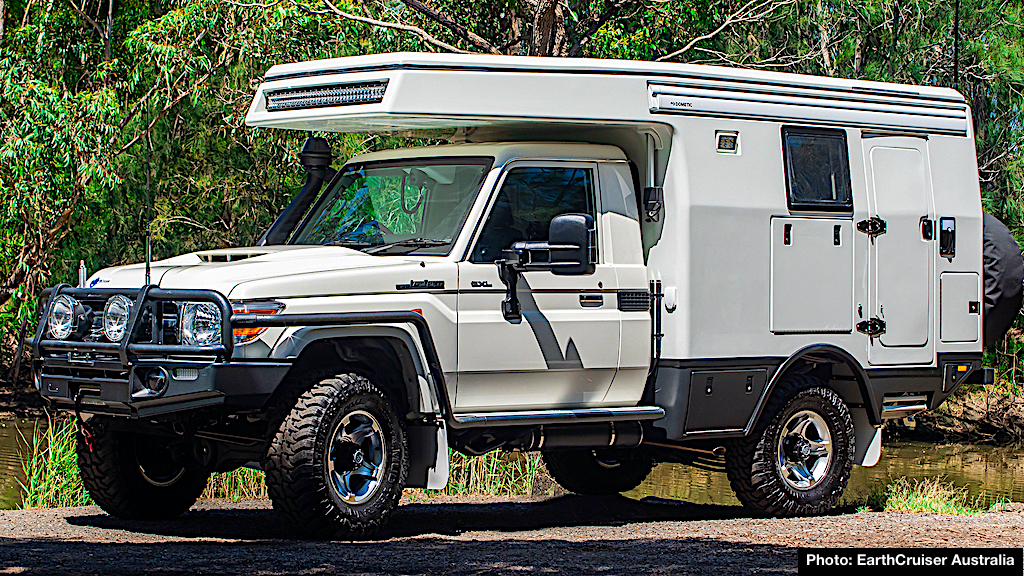

For the price of two Calis you have better options. As they say in Australia: Yes, you can get to the outback with a Landy, but only can return from there with a Toyota Landcruiser.
240.000 Australian dollars. A 195×138 cm sleeping area for two people, 12V BBQ set, about 400 Amps Lithium battery. Based on the 36-year old Toyota Land Cruiser 70 model. Seems to fit in a parking garage.
