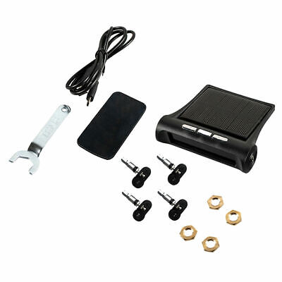

You could fit a cheap TPMS system which has the benefit of showing tyre pressures removing the need to manually check tyre pressures.
I have the TyrePal system which just has sensors that fit onto the standard valve, not very convenient to use as they need removing to inflate tyres and then refitting quickly to prevent tyre pressure loss. They do internal type ones but more expensive.
Chinese ones available (where just about everything is made now) that may be worth considering. They work alongside the basic VW system giving you more detailed data.
example
