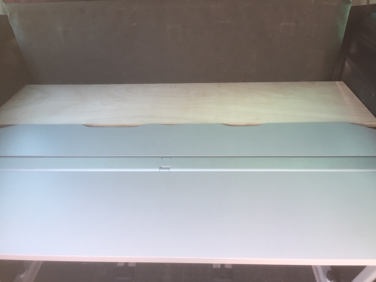

Got the multiflex extension or kitchen work table cut today from 18mm ply. In fact, I got two cut: 1500 x 380 mm and 1500 x 450 mm. This gives a fixed rear bed size of 150 x 96 cm or 150 x 103 cm. I’ll try the two boys out on it tomorrow.

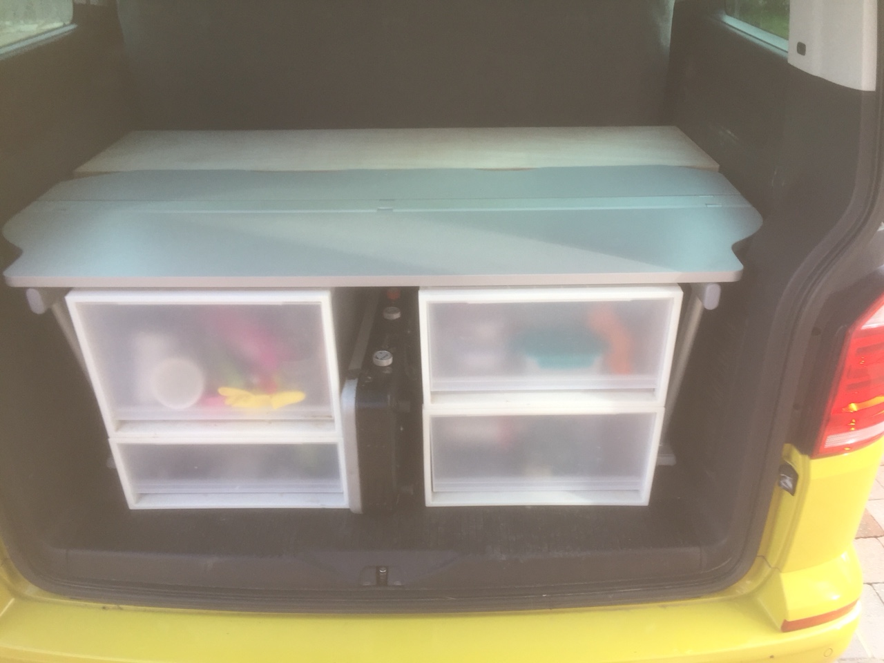

I’ve ordered four folding legs for one of the MF extension/worktop tables. The board fits snugly on top of the two trays, but with the legs correctly attached it will be held securely in place with the legs tucked neatly within the tray cavities. The board sits 1 - 2 mm lower than the top of the MF, but once the trays and board are varnished this small drop should be even smaller.

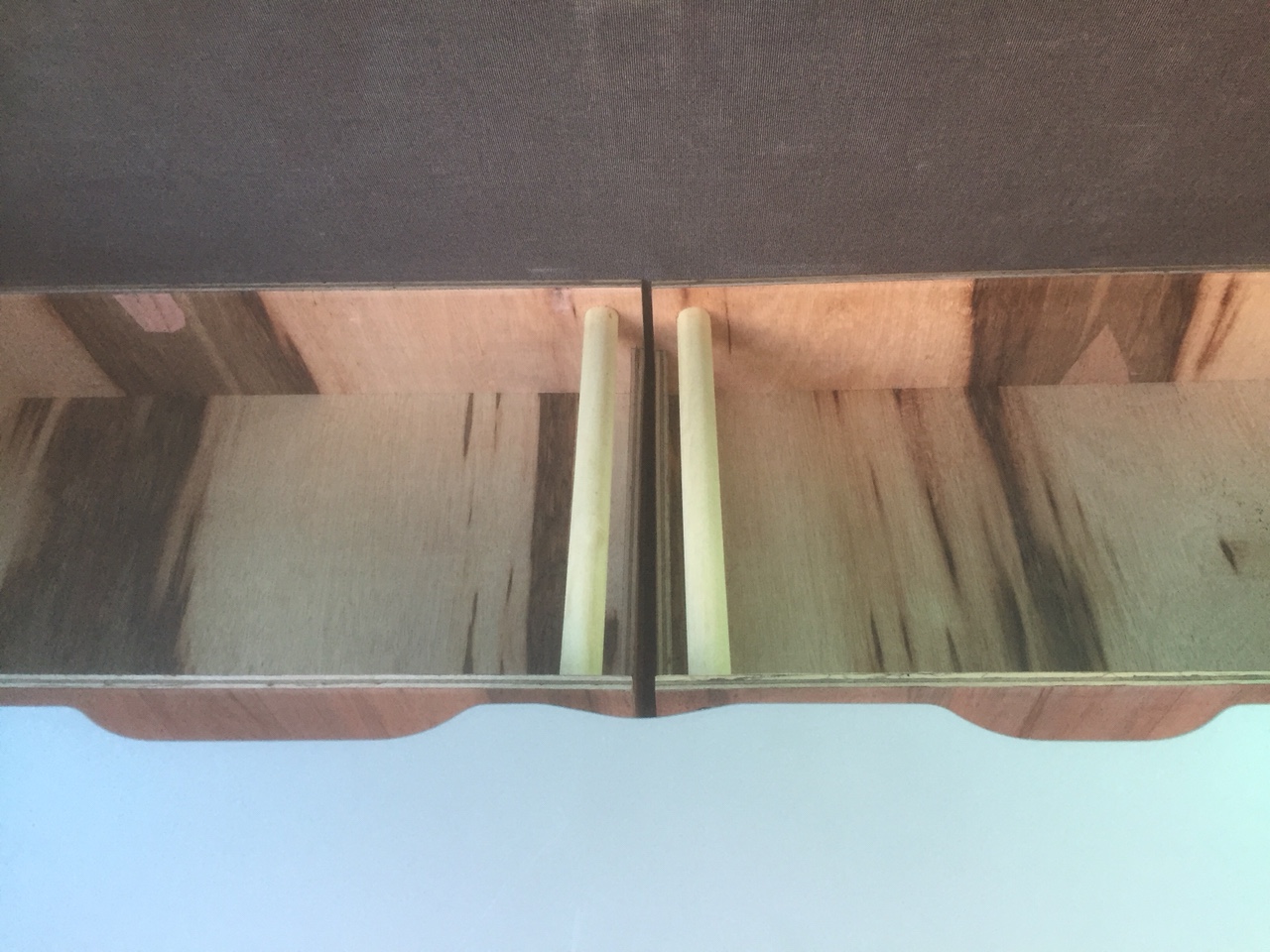

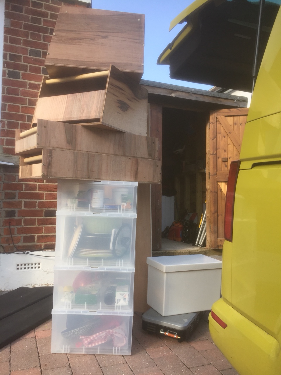

Crates to pack under the multiflex and multiflex extension.
From top to bottom:
Two 540 x 480 plywood crates
Two 750 x 380 plywood trays
Four muji drawers
Gas box for two 907 bottles
Double gas burner and grill

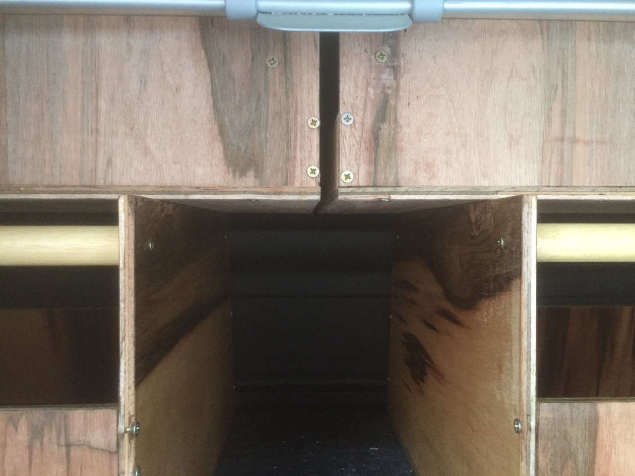

Under the MF extension
Two varnished crates supporting two unfinished trays, with a gap between the crates for the gas box.
The two trays seen from above between the bench seat and multiflex. The bench seat is positioned so if dropped it will make the standard bed without the bench needing to be moved fore or aft.
The MF extension in position.
The boot fully packed with everything seen in the first photo.
