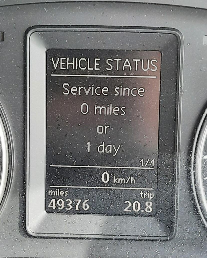

It just says this. It is an early 140 if that makes any difference.

Must be because of the year. Mine shows miles/days to Oil Change and likewise to Inspection/Major Service.
