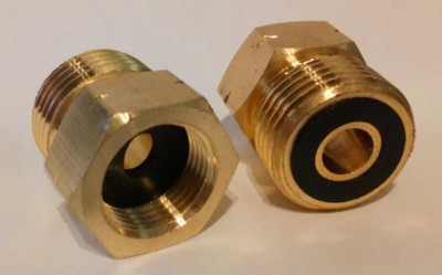

Can I use one an adapter like this
https://www.amazon.co.uk/dp/B001HXM0XO/?tag=eliteelect-21
to connect a small CV300 gas bottle to the California ?
It can not attach to the regulator, perhaps it can be used to screw the valve that sits on top of the 907 to a CV300 ?
I would like to keep a small CV300 gas bottle as emergency spare to simply finish cooking a meal if my large 907 bottle runs out.
I do not want to carry a 2nd 907 or 904.
Can anyone help please?
I would just need to find the right connector/adapter to use a small gas canister (eg a CV300) temporarily when my campingaz 907 runs out of gas.
I don't want to cut the pipe and replace the existing cali regulator, ideally just connect to it.

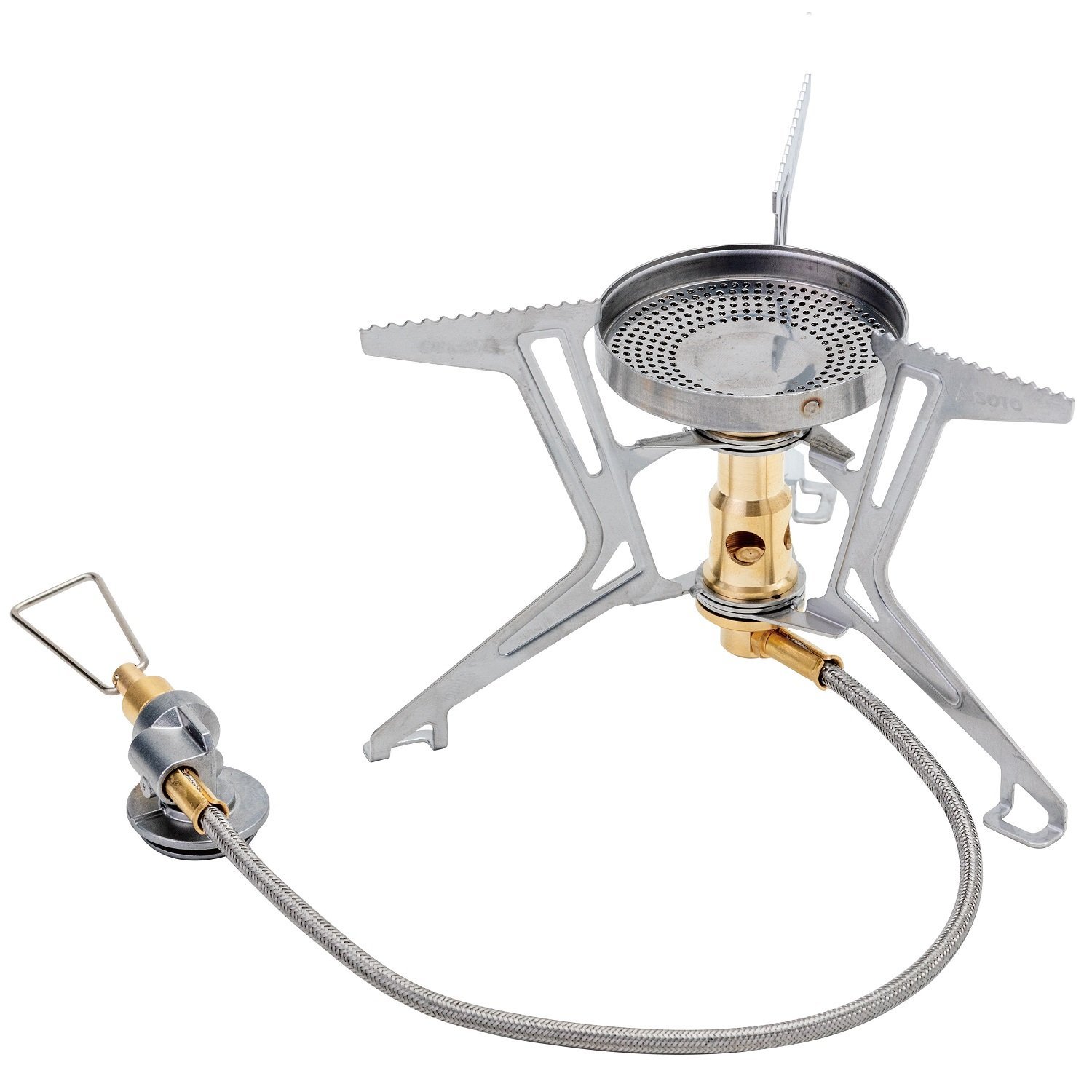

My approach is the exactly the same. We carry a Soto Fusion Trek stove - tiny, brilliant bit of kit. Our Cali is just coming up to 4 years old and at Easter the regulator packed up. We just cooked on the little emergency gas stove instead. Not the cheapest gas stove, but totally worth it.

So I was intrigued by using an adapter as a stopgap. Is it doable ?
Not sure you can do this as the CR300 is presumably High Pressure whilst the campingaz 907 is Low Pressure. The GOK regulator is presumably not designed to receive HP. Cadac do an HP to LP converter but you would probably need a quick release in the existing pipe to then swap it over. Safer to just do as already suggested and have a back stove until you can get the bottle replaced.
thanks @pastyman - I had hoped I did not need a pipe change just using some magic connector between the existing one and a cheapo small bottle

I had the CHF AV 121 valve but it did not connect to the Cali regulator. I suppose the 'craft' adapter is what I need to add ! I'll see if I can find one in the UK
If you find one and it works please update this post. There must be others thinking the same.
I was a bit shocked by the price but it looks well designed and compact. What gas canisters do you use. Was looking for Soto gas but not many places have it.
Soto is roll royce, look for
HIKENTURE Camping Stove on amazon. any gas cartridge with screw mount will fit. Primus, soto , …​
