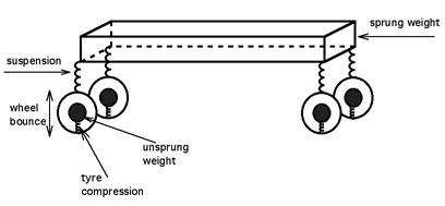

How is changing the wheels going to affect the Vehicle Suspended Weight. It might affect the Vehicle Total Weight but seeing as the vehicle body, chassis, engine etc is fixed to the axle + wheels via the suspension system that suspended weight will be unchanged.
It does change if the wheel is lighter.
Cheers
Enviado desde mi iPhone utilizando Tapatalk
But you are right, I meant unsuspended weight.
Cheers
Cheers
Aah. Different thing.:thumb
