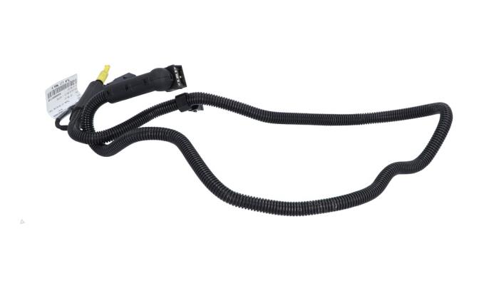

wrong part number the one i am looking for is 7LA131984H

Thanks I have been in touch with them but it is the wrong part number the one I want is 7LA131984H
That part appears to be an electrical cable not a pipe? In which case any decent vehicle electrician should be able to repair fairly easily. A quick google shows a complete second hand cable available in Holland for 45 euros & its easily posted.
