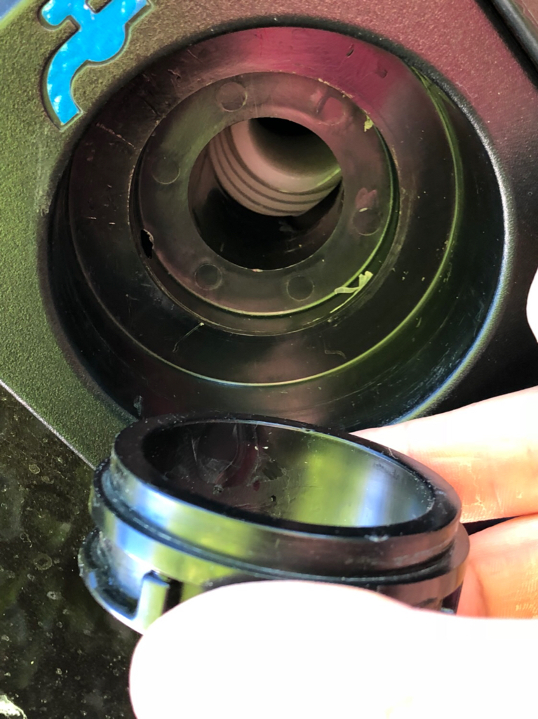

I have had a similar problem with mine. On my MY17 Ocean, I took off the cap to fill the tank today and found I could not secure the cap properly. When I looked closer, part of the filler had com off with the cap. The two parts do not seem very securely attached to each other- a friction fit is not enough. I'm off in the van after work tomorrow, so I think I'll glue it in with "evostick" glue for now. When I get a chance, I'll use a couple of blobs of sikaflex. I noticed when I was driving that rather a lot of water was coming out around the filler.
For the record, I glued the fitting back on with sikaflex. Tried rubber solution glue but that didn’t work.
c5ad40cdc83b4537df86974abd52a0b6.heic
Looked was originally stuck on with two tiny blobs of clear glue.
This is exactly what has happened to mine - the glue for the locking sleeve appears to be totally inadequate thus the locking sleeve comes away with the water filler cap - took me a few minutes to work out. What adhesive have people used to re-attach the locking sleeve to the body ?
Sikaflex is easy to apply, waterproof and a very strong adhesive.
