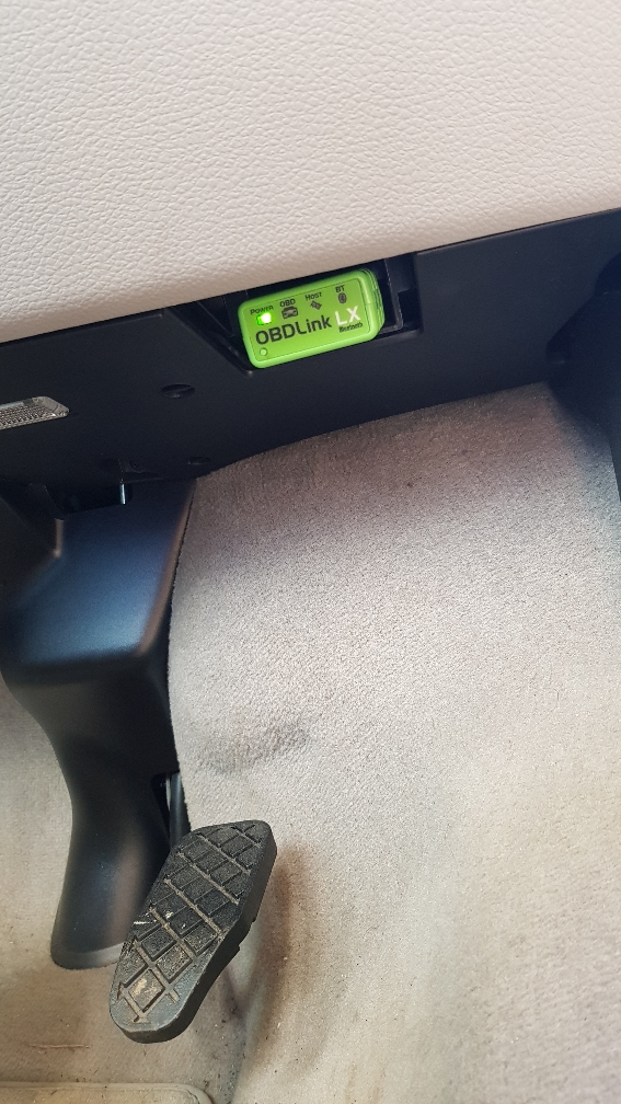

I too had a VW dataplug for a short while and it stopped working.
I wont be able to answer your question unfortunately as I have moved to another "Dataplug" type device so I can keep an eye on my EU6 Diesel DPF filter percentage (in case I wish to run the engine on idle for a brief period during summer for aircon or for charging batteries if im static for long periods) or check engine codes in detail if a light decides to pop up.
I think the data plug from VW is a nice concept but I felt it tied me into a VW ecosystem which, since my warranty expired and during reduced support during lockdowns, did very little for me apart from feed usage and positional data to VW and I felt that was unnecessary.
I chose to switch to a very reasonably priced ODBLink LX (see photo) to provide me with the features above and it has truly saved me several times from unnecessary DPF issues.
