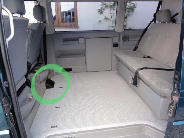

Intrigued to know about the seating layout. Has your multivan got any of the vents (circled) in the floor behind the driver and passenger seats?
If that's a RHD T4 then I think the heater outlet circled is from the heater fed from the engine coolant circuit.
The parking heater outlet is very similar but on the left side. The actual heater (factory fitted) is below the floor behind the left front seat. On a RHD T4 the heating air inlet is in the sliding door step.
Rod
