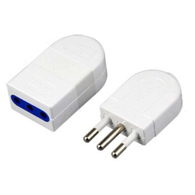

The campsite in Spain says:
"Electric connection: Blue European plug for exterior. Adaptor required."
Is that this
Or this
I always carry B in the safe for emergencies. I think Italy has a lot of them still.
I expect “adaptor” is a mis-translation for hookup lead.
Anyway, I have four adaptors or leads.
#1 short European 2 pin to external round 3 pin.
#2 10m External round 3 pin to circuit breaker with 3x UK sockets plus 2x USB.
#3 short UK to round 3 pin
#4 10m standard hookup
Intend to run #2 into the driveaway awning for electric hot plate and kettle, then #3 and #4 from the awning to the van.

Good to always carry both when you're over here in mainland Europe. At most (modern/large) sites you'll encounter the first one in the photo, but if you enjoy smalller, more remote campings or staying at farms, or parking up in urban environments, the second can be a lifesaver when looking or a hookup.
A …. because continental folk have hook up leads with B on the end and need an adapter for A.
