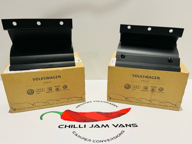

Our awning just blew up vertical. Yes really.
It’s kind of reset itself and I’ve wound it in. I think I need this part front and back.
I need it in a week or no awning on holiday in heatwave.
Where will be the quickest place to get these 2 pieces? And can anyone @WelshGas tell me the part number??
It’s sheared off the lower bolts but the top ones are still there.
Is this it?
Is this it?
That’s was priced in Euros and I need inside of 5 days. Thanks for help. I went for the one above.
Fingers crossed.
Fixed after a lot of twiddling this way and that. In the end my roofer neighbour worked a bit of roofer magic and we managed to force it home. I think the awning case was probably bent a bit by the gust of wind.
My neighbour was wearing a Top Gun t shirt only ‘Gun’ was substituted for something else. Priceless!
Thanks again to @Ch1pbutty for help finding the parts.

It’s pretty funny - well apart from the £170 bill - that this happened in the New Forest with a bit of drizzle. Just one gust and up it went. Quite dramatic.
Having taken it apart to put it back on, it almost seems like it’s designed to fail in a way that doesn’t do any damage to the awning itself or the case. Just one bolt at each end popped through its aluminium holding and the connection pieces to the van bent. Hence these needed replacing costing £170. You can see here
