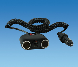

You could consider this option for the socket in the boot
Great thanks everyone, I’ll have a fiddle about with it and look at that splitter.
