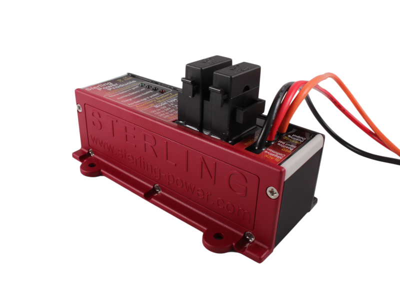

IMO a good option for adding to an existing installation is the Sterling Battery to Battery Maintainer. It's fairly cheap and doesn't require wires to be run between the batteries, (it' can be wired across the split charge relay under the passenger seat. Not designed to re-charge a flat battery.
This sounds ideal! Thanks for this.

I solved the starter battery problem with this .....
Throw the switch (4) when parking up for a long time and the solar keeps all the batteries full.
Got one of these today, works well (main battery is only 3 years old, but van sits on the drive a lot as EV now gets used as daily driver, so battery was flat a few days ago). Just need to shorten the cable; works well on the dash plugs as one is 12v is main battery, the other 12v leisure:
