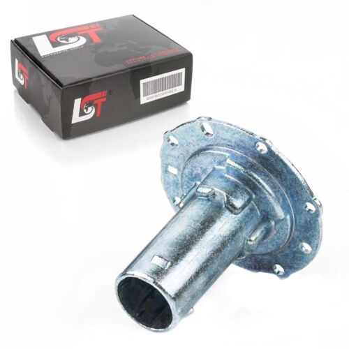

Actually all that’s broken is the upper mirror casing (about £100 painted) the lower mirror casing (£15), the heated mirror glass (£15) and the top hat metal bracket that projects from the folding motor. Unfortunately VW do not supply the bracket separately from the motor mechanism and the whole unit is including the motor is about £500! However you can get the bracket from a place in Germany and a place in Turkey (link below) and then strip the unit down which involves using a spring compressor and lots of photos so you can remember how it fits together. The brackets that are widely available on eBay are for the non folding mirror and don’t fit.

The motor and mounting bracket, which is the part that breaks. Even this is not available separately and you have to get all the plastic frame it sits in.
