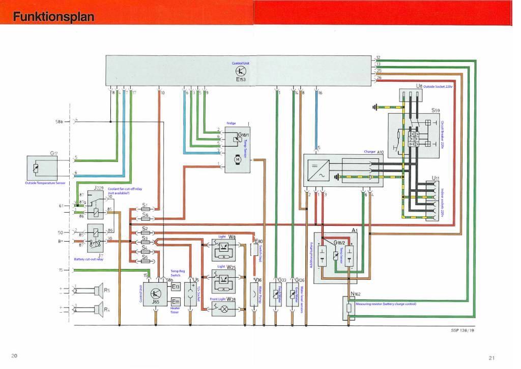

Not the best quality but might this be useful?
You’re a star @ArcticMatt. That’s a really useful diagram. My comment about quality was more about the file I’d managed to find on a previous thread not the draughtsmanship.
I never doubted you :) I know what it's like when you save these JPEG's over and over. They just get worse and worse. The text wasn't big in the first place. Hope you get it all sorted.
