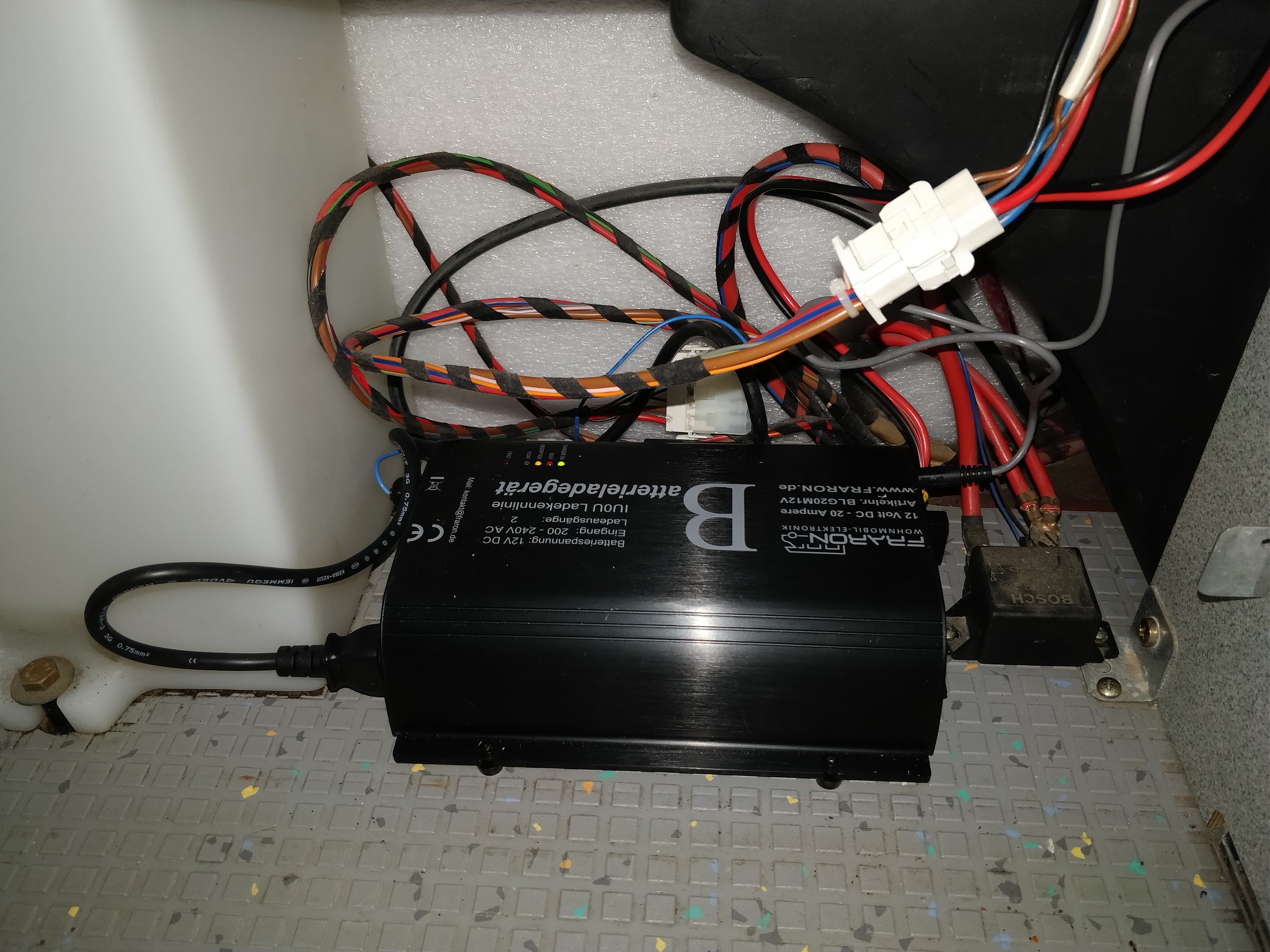

So I am sorry to do another charger question, but I can't seem to solve my issue searching the forums.
Car is Westfalia California Biker -96.
When I connect my mains 220v the voltage on the panel goes up to 14.2V briefly, but then it goes down to 13.5V again (same as unplugged).
If I disconnect the mains the charger makes a few ticking sounds.
Measuring the voltage on the B+ and B-1 from charger also shows 13.5V same as battery.
When connecting a seperata CTEK charger from the same 220v outlet I can charge leisure battery fine showing 14.2V (same as when driving.)
Cable symbol on panel does not show at all.
So a few questions.
1. My charger is not original?
2. Should my set-up charge both engine and leisure battery?
3. What charger should I replace this with if it is broken?
Thanks in advance.
