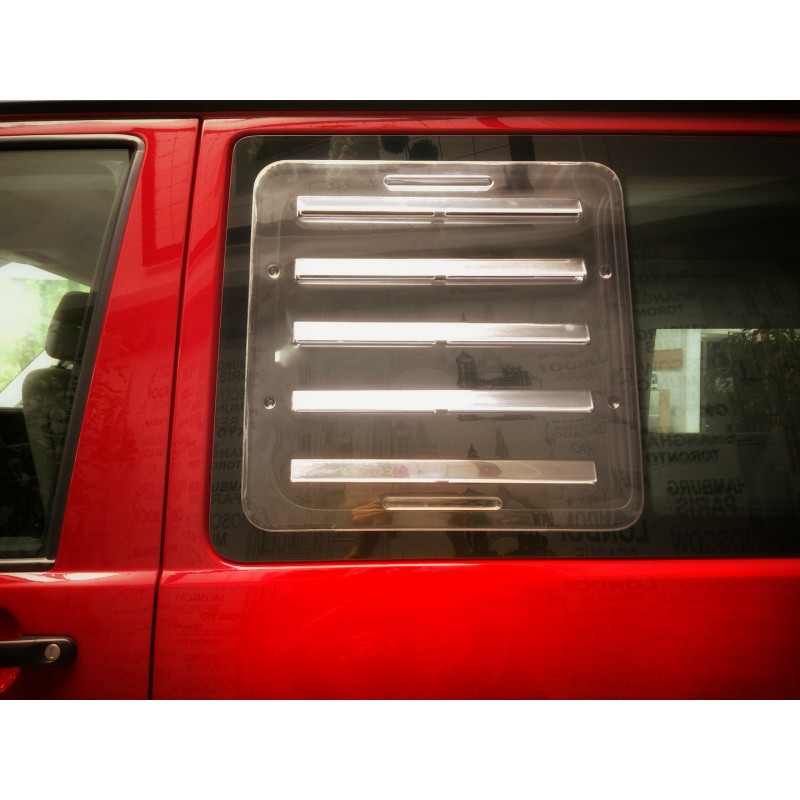

This is really good - lots of ventilation and built in bug screen. The metal feels secure enough to leave van parked with it in too. Its really expensive though: https://www.cmccampershop.co.uk/product-page/vw-t5-t6-t6-1-sliding-window-vent-factory-glass-only
We just have one on kitchen side as its in perfect place to vent steam from the kettle as well.

An alternative for less than half price

Alot smaller/less vents and from what I read above, no built in bug screen though. And looks like plastic so not as secure if leaving the van presumably?
Yes to all that, but does let more light in. I have thought something like these could be useful, when cooking in the van in the rain. But in the end I can crack the cab windows and use the ventilate function in the rain, even if I'm out. If not raining of course I can use the fly screens and just open the window.
In the end I wonder if they are a solution looking for a problem.

I like that mine blocks some light, because I dont want to put the blinds down on that window otherwise it would block the vents. The window to the left is slightly obscured too from the outside because it has two layers of glass covering it with the slider fully open. I can further block visibility from the part not covered by the vent if I have the glass cover for the cooker open also, but rarely do when not cooking.
Do you have wind deflectors on the front windows? I have thought about them, so that I could crack the front windows also, but since I had one of these side vents I have never had condensation yet.
Before I had it, demisting the front windscreen in the morning would take literally FOREVER...!

Yes I had them fitted from new by the dealer. They are useful, but do get obscured by my windscreen cover, so suppose aren't fantastic at ventilating at night. As you, I don't suffer from condensation, but we do have the top up often. I think if I was off grid more, especially park4night pub car parks, I think your metal version would be the choice, but if I was on campsites, cooking in the rain I think I'd go for the perspex and close the blinds at night - you'd still get some airflow except on very hot nights.

We have just one from a Company called SpaceCamper in Germany, we used it constantly except when travelling longer distances at speed.
It great in the rain, we've had a fair bit of that this trip, no leaks at all and bug proof.
130 euros. Unfortunately they don't ship to the UK, we picked ours up on route

Same ones, highly recommended for summer and winter, they keep out more water than the closed side window
I presume they’re plastic grids. Aren’t they easily broken by the bad people?
Made with an aluminium frame and held in place with a knurled screw arrangement on the inside, there is a video on the SpaceCamper site that shows fitting.
Here are a some pics.
