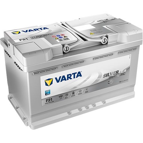

Varta LA80:for leisure and Varta F21 for Engine.
If you check on Tayna Batteries website both batteries are AGM, both have similar specifications BUT one is recommended for Leisure and one for Engine.

I would use the LA80 for the starter as well, suspect it's only the sticker that differs from the F21. LA80 is duel purpose & states it can be used as a starter battery.
Except when I bought my replacements the F21 was cheaper than the LA80. Don’t know why.
