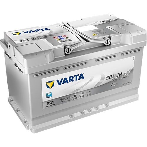

Thanks for the pointers - I checked all sockets and lights before charging last week but will go over the van again to be sure. It was sluggish again to start after work and I attach a photo of the starter battery - doesn’t look like anything non standard has been added to either terminal but tbh I don’t know what standard looks like... in terms of ICE and gizmos it’s very standard also. Just the basic radio/CD with no nav and no dashcam or auxiliary anything. Will charge overnight to ensure I get to the battery health check tomo! 4D0BDF77-F8DF-4257-9799-15F811898B94.jpeg
Thanks for the pointers - I checked all sockets and lights before charging last week but will go over the van again to be sure. It was sluggish again to start after work and I attach a photo of the starter battery - doesn’t look like anything non standard has been added to either terminal but tbh I don’t know what standard looks like... in terms of ICE and gizmos it’s very standard also. Just the basic radio/CD with no nav and no dashcam or auxiliary anything. Will charge overnight to ensure I get to the battery health check tomo! View attachment 70702
Someone has swapped the battery. That is Not an original VW battery.
Definitely a Budget Battery.
That battery doesn't look like an original one
and on a 2017 it should still have the original Vw one
unless it has had issues before.
I might be wrong though
Looks like the battery has been swapped out. Perhaps at time of sale?
The Cali needs the new battery to be coded so that the correct charging regime is applied by the smart charging system - perhaps this was not done.
Is the Lion battery of the AGM type? It needs to be to support the Start/Stop system correctly.
You mention that you have a battery function test booked in with VW. This should identify any faults.
With the harshness of winter about to set in, I should prepare to buy a quality and properly rated AGM battery. You can get a suitable battery around 1/2 the price it will cost at VW. Loads of threads in this forum on what to buy.
Thanks @westfalia @WelshGas @Alan Andrews
Perhaps it started life with a Moll and was replaced with this after-market Lion AGM battery - I'll enquire with the previous owner as to when that was to determine if a charging regime was coded or not. The battery check is with Kwik Fit actually - not ideal I know but they had next-day appts unlike my main dealer. Might you be kind enough to share the OEM Varta battery model that seemingly replaced the Moll?
So - to close out the thread for those that helped me. I actually got the starter battery health check completed today and it confirms that one of the cells is bad so the battery is a dud and needs replacing. On a positive note the charging system was indicating as expected so that’s a good outcome.
The seller has agreed to supply and fit a replacement so I’ll get that done and request it is a Varta F21 AGM that’s fitted as linked by @WelshGas
I’ll also mention the coding that’s apparently required when installing the new battery.
Thanks again for all the support.

Rather frustrating I’m sat in VW Greenhous Wolverhampton and they can’t code the battery (Varta F21) I’ve supplied to them for fitting and coding.... apparently it’s uprated from the one that’s supposed to be fitted? 80Ah instead of 75Ah and 800A instead of 750A.....
I mentioned the advice from this forum and they agreed the history with the duff Mol batteries - but said because the specification of this new battery isn’t the same as standard - then they can only fit it but not code. They reckon the only disadvantage for not coding would be if I go to later add tow bar prep or other ancillary electrics - but no coding wouldn’t interfere with general use. Is this accurate?
The coding tells the computer that the battery is a new full capacity battery and supposedly adjust the charging regime accordingly.
would VW not set the battery recoding at the same as factory spec ?
I’ll ask what they’ve set it to (haven’t left yet) but the update to me was that the selectable ranges don’t include my new Varta spec.
Apparently no coding can be done - so it has been left uncoded. So I’ve got a brand new Varta F21 fitted for free that will apparently cause no issues to bluemotion or stop-start unless voltage drops below normal levels. Slightly disappointed about the coding but reassured that the new battery quality will give me confidence to leave it several days without plugging it in like a Tesla!
Well the F21 Varta was a direct Replacement for my Factory Fitted Varta and the new one Coded no problem.
You can either code the new battery with the supplied code, or you just change the serial number of the Old Battery by 1 to initiate a new Learning Mode, so I don't know what that Dealership is doing.
Yes - it’s surprising the dealership couldn’t come up with an alternate plan of action to get around this stumbling block, either one you propose sounds good to me - particularly the initiation of learning mode. Apparently the dead ‘Lion’ battery wasn’t coded so there was nothing to the change the serial number from....
