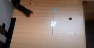

Make sure the hot water reset button is accessible.
I just had to wait 4 hours at dealer while they removed the double passenger seat completely ( 20 or so screws ) so they could press the reset button. It had 4 trip codes including 632 H
One of these thread has this pict
but as mine is still under warranty i want VW to do it.
